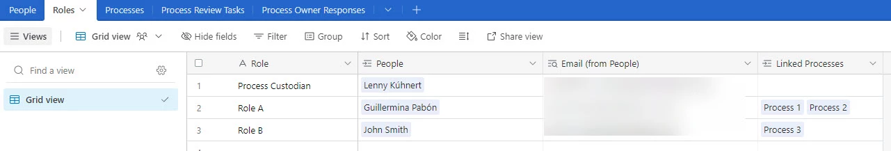

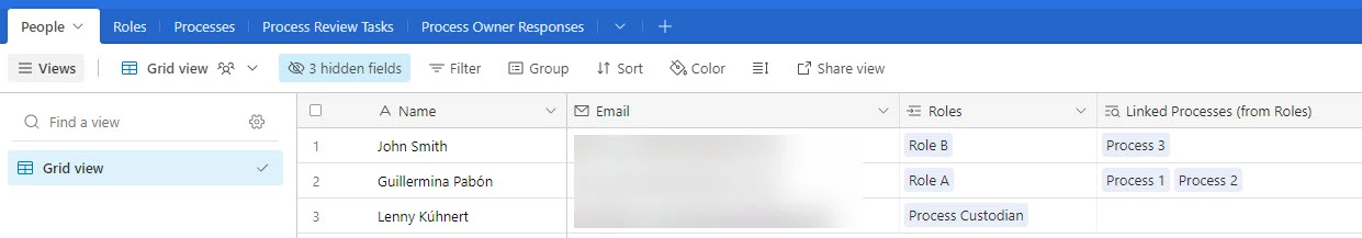

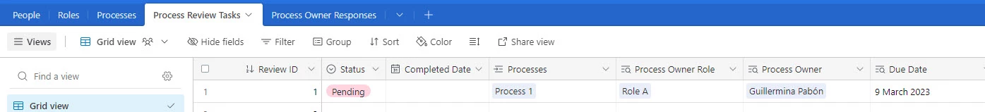

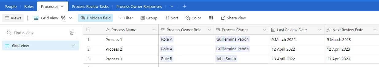

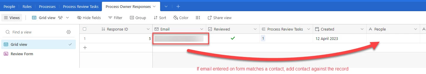

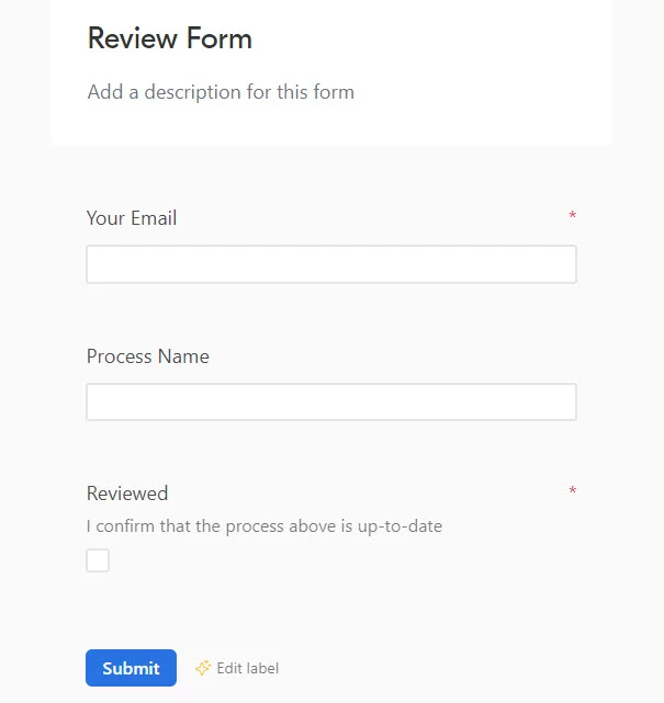

Thanks for the quick reply Adam, much appreciated.  Please don't apologise.
Quick Overview with excerpts attached.  You can access if you like, it's all dummy data for now - https://bit.ly/3mzMkjt
The Base manages process.  There is a list of processes (one table), and each process has an owner who is responsible for reviewing the processes once per year.  There are two tables to manage the owner, one is a table for roles and another a table for people which includes their email address.
1 month out from the process review due date, I've set up an automation to email the process owner to remind them, and this sets up a task in a new table with a status of pending.  In that email I send a pre-filled form linking the response back to the process.  Once a user completes the form indicating the process has been reviewed, I will have automation to update the task to completed status, set the process review date to today and make the next review date one year from now.
I pre-fill the email address but don't hide it, as it's possible that the process owner is away and delegates to somebody else, quite likely somebody who is not already in the contact list.  For this reason I'd like to pre-fill the email but have it editable.  I have the form linked to the review ID which is hidden, and the process defaults to the one linked to the task.  Ideally this would be visible but not editable but Airtable doesn't seem to support that.  I need the user to see this to confirm they're reviewing the correct item.
Now to the actual point at hand, when this form response is received, if the email address on the response is a match to a person in my contact list, then it should link that response back to that person's record.
I'm a Business Analyst so I have experience setting this sort of stuff up with developers in proprietary software, but first time in Airtable trying to construct myself sorry.  This is my very first attempt at Airtable.
Thanks in advance for sparing any time.
Regards, Brendan    

Thanks for the details!  So we're trying to link the "Process Owner Responses" record to the appropriate record in "People" based on their email?
If so, try:
1. In "Process Owner Responses", convert that "People" field into a linked field to the "People table
2. Create a new automation that triggers when a form is submitted
3. Give it a "Find Record" action that will look for a record in "People" based on the email
4. Give it an "Update Record" action that will update the triggering record's "People" field with the record ID of the found record from the previous step
And here's a link to the base with it set up for your reference

Thanks so much Adam, I was quite close but 90% may as well be 0%!  That's all working, can't thank you enough.
I'm hesitant to accept as solution to mess with original post, but happy to do so or create another post as you wish.
Getting this done now has boosted my confidence, now for onto the next challenge 😄
Take care. Regards, Brendan
