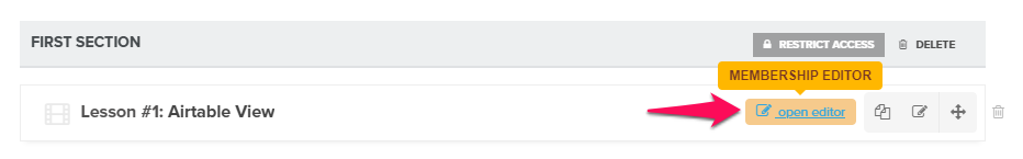

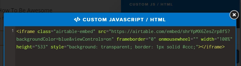

You could embed an Airtable view in your membership area in ClickFunnels.

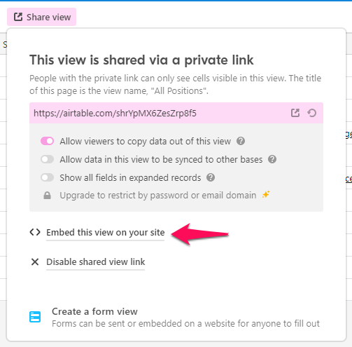

In Airtable:
  1. Click on Share view > Embed this view on your site

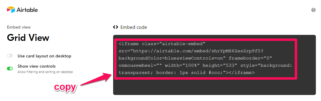

  1. Copy the Embed code to clipboard

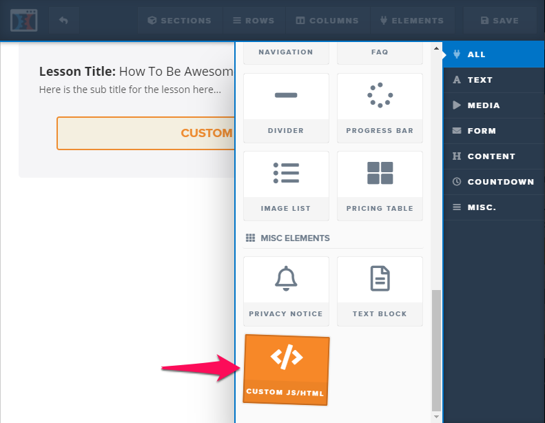

In ClickFunnels:
  1. Open the lesson editor
  1. Add Custom JS/HTML element

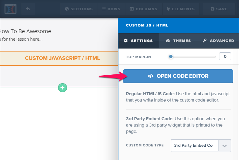

  1. Click on the just added Custom JavaScript / HTML element
  2. Click on Open Code Editor
  1. Paste the Embed code from Airtable and close the code editor
  1. Select “3rd Party Embed Codes” in Custom Code Type
  2. Click Save in the lesson editor.

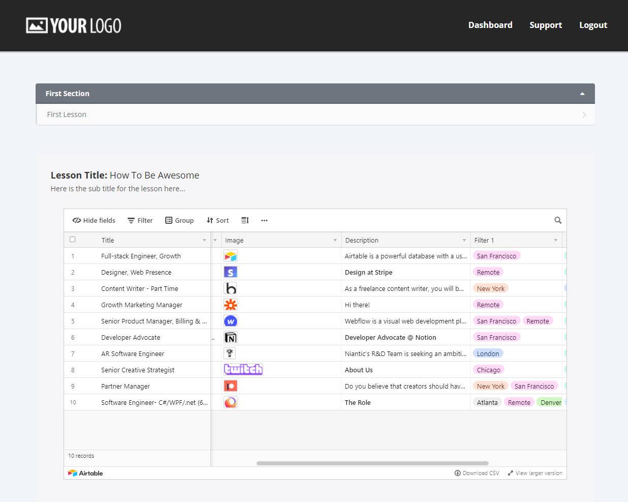

When you log in to your membership area then you’ll see the embeded Airtable view.
Neverthelss, embedding a view doesn’t guarantee that it will be 100% secure. Tech-savvy members may extract the view URL and share it outside of the membership area. And as you noticed, there is always the risk that they can just share their username and password.
