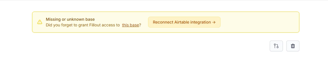

I feel like this might be a Fillout issue but thought I would check here to see if anyone can identify if I'm doing something wrong.  I have a base connected to a form in Fillout.  When I pull up the form and click “integrate” at the top, it shows a connection to the correct table.
When I click back on...
  • Edit at the top,
  • Go to the page that contains a field linking to a subform
  • Click the field the subform is attached to,
  • Open settings on the right
  • Click Edit Record creation form to pull up the form,
...it says connected at the top, but when I click the integrate tab on the sub form and look at my connections, I continue to get the following message.
I've updated my API Key in Fillout, updated my PAT Token in Airtable, cleared my cache, confirmed my mapping is correct, I don't have any automations that might cause the problem,  and tried a different browser.   I was connected to a different base and it was working properly.  Short of recreating the entire form, I'm stuck.  any suggestions?
  • Jun 26, 2025 3:25 PM UTC
Fillout doesn’t use Personal Access Tokens, it uses oAuth to connect to Airtable.
So I would try deleting your Airtable integration and then re-connecting it again.
You don’t have to delete the entire form… you can just delete the integration and re-connect it.
If it asks, be sure to give Fillout full access to your bases & workspaces. (It might not ask — it might just automatically take full access for itself.)
More information on connecting to Airtable in this Fillout support article:
How to create an Airtable form
Hope this helps!
If you have a budget and you’d like to hire the best Airtable consultant to help you with this or anything else that is Airtable-related, please feel free to contact me through my website: Airtable consultant — ScottWorld
  • Jun 26, 2025 4:44 PM UTC
That worked!!  Thank you so much.
