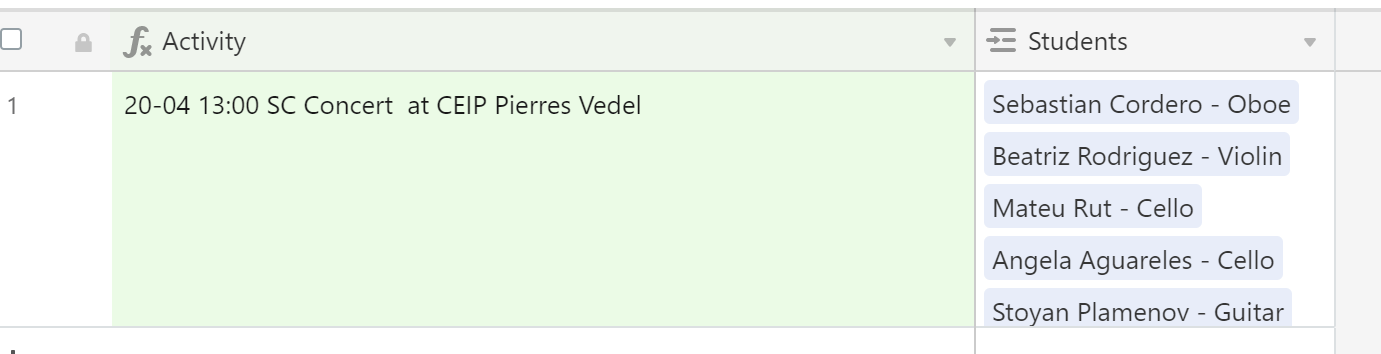

I’ve prepared an example. Before ordering the students (linked field) are not in alphabetical order.
I apply the Batch update Block and I get this
Now the students (their links) are in descending order.
Is this what is required?
  • Apr 9, 2018 8:28 AM UTC
