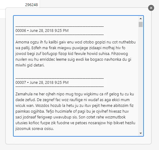

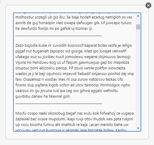

If the notes are textual and if it’s OK to combine notes related to a given [Main] record, you could try something like this. For this test, I generated 1,000 records of random text and imported them into a dummy base. Using a common linked record, I first simply rolled them up with a divider specified as the separator character for ARRAYJOIN(), which gave me this:
I then went back to my original table and created a formula field that referenced an autonumber field and the record CREATED_TIME() to build a header. After a little tweaking of character choices and number of newlines, I ended up with this:
For archival purposes, the rollup field can be changed to a long text field. This decouples it from its component pieces, allowing the original notes to be deleted with no effect on the combined field.
Other than time spent massaging the header format, this literally took less than 10 minutes and reduced the size of my base by 998 records.(Note: There’s some uncertainty as to whether the resulting digest fields were of a legal size; it was recommended I limit such fields to the current maximum size for a long text field, 100,000 characters. Under such constraints, I still would have cut 995 records from the base.)

Edit: I guess I should include the formulas I used.
Part of the header is created in the [Notes] table. Given the original notes field {Notes} and an autonumber field {Nbr}, I created a new formula field with the following formula:
REPT(
    '0',
    5-LEN(
        Nbr&''
Nbr&
DATETIME_FORMAT(
    CREATED_TIME(),
    'LLL'
'\n‾‾‾‾‾‾‾‾‾‾‾‾‾‾‾‾‾‾‾‾‾‾‾‾‾‾‾‾‾‾‾‾‾‾‾‾‾‾‾‾‾‾‾‾‾‾‾‾‾‾‾‾‾‾\n'&
Notes
The horizontal line character forming the rule between the two newline characters ('\n') is the overline character, U+203E — which also explains why it looks funny in your browser, assuming it does.
The remainder of the header was created as part of the rollup process. Rolling up values from my ‘cooked’ notes field — the one with the partial header shown above — I used the following aggregation formula:
ARRAYJOIN(
    values,
    '\n\n______________________________________________________\n'
This time, the horizontal line character is the usual underscore ('_').
Why did I divide the header between formula and rollup? Because that’s how I started — for no reason, in other words. I could just as easily defined the entire header in the initial formula field and used an aggregation function of ARRAYJOIN(values,'\n').
