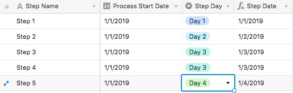

Let me make sure I understand your goal clearly. It sounds like you’re plotting individual steps of a multi-step process, and want to use the DAYS field to control the date on which each step will be done. For example, if your process begins on January 1, setting a certain step to be Day 1 would mean it’s to be done on January 1, setting it to Day 2 would be January 2, etc. For example:

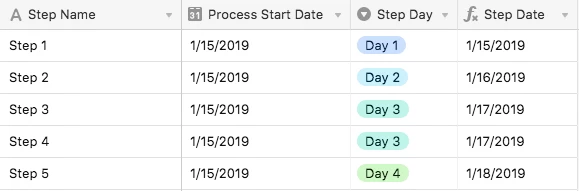

However, if your process needs to shift to start on January 15th, you want all of the Day X tags to shift to target different days, like this:
Is that correct? If so, here’s the formula I used in the Step Date field:
DATEADD({Process Start Date}, VALUE(RIGHT({Step Day}, 1))-1, "days")
If I’m off-target, please let me know.
