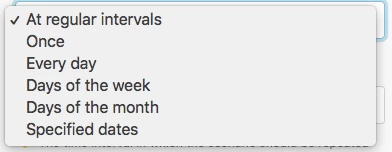

Triggering automations on a timer instead of a data change is doable in Integromat. I’ve got several Integromat scenarios that run at specific intervals—some daily, others weekly—and operate on Airtable data based on searches. To set this up, make the first module in the scenario an Airtable search module. Set up the search as you wish to find specific data in a table, and add other modules as needed to operate on the records returned from that search.
On that first module you’ll see a clock symbol. Click that to open a dialog where you can specify the schedule for running the scenario.
To do something similar in Zapier, start the zap with the “Schedule by Zapier” app, following the prompts to pick a time. Zaps can be scheduled to run hourly, daily, weekly, or monthly.
