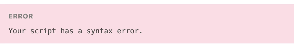

I am attempting to set up an automation and have a script update a linked field in a table. When testing my script the output gives me this error. “Your script has a syntax error” (adding this for search engines cause I could not find this on google at all)
The bit of code that makes this error happen is this (it has no syntax highlighted saying it’s an error)

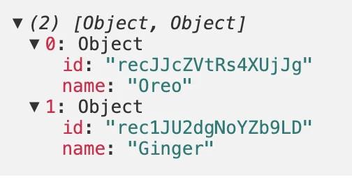

dogs is an array of objects (“dog” records) like this.
I’m not sure where to go from here cause this error leads me nowhere. I have tried just passing an array of IDs. I’ve tried passing an array of objects with just the IDs and not the name. Nothing has worked so far. Is anyone able to tell me what I’m doing wrong?

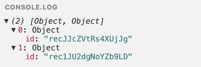

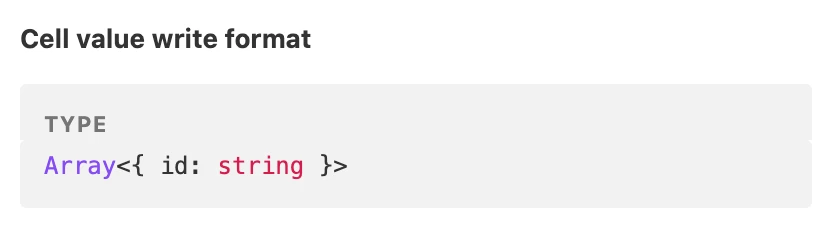

Hi @Marlene_Kingston - if depo is a single record and updateRecord singular is what you are after, then I think it might be dogs array that is at fault here. I’m assuming that ‘Dams’ is a linked field - if so the write format for a linked field is:
So, your dogs array needs to be:
[{id: 'recabc123456789'}, {id: 'recxyz43434343'}]
so exclude the name attribute
‘Dams’ is a linked and I am attempting to update only a single record. I have tried the format you suggested but no dice.
It still gives the same error.

I got it figured out. It doesn’t let you await in a loop. Not sure why. I just took out await and it worked.

Ok, I can’t believe I forgot to mark my function in my loop as async. You’re right about updating them in bulk, but I have over 50 records that need to update so I still have to update within the loop, but I currently have it set up to update the max allowed records at a time on each iteration. Thank you.
I might also mention that I needed to change the way I looped since the await doesn’t run in a forEach. I changed it to a for of loop and wrapped it in an async function. Now everything is working as expected.
