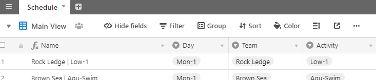

@Karen_Kunkel - You’re thinking spreadsheet and we need to get you thinking database. Have a look at this base.
Camp Schedule - Multiple Views - Airtable
Explore the "Camp Schedule - Multiple Views" base on Airtable.

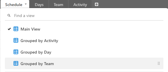

Without knowing too many details, here’s a quick rendition of my initial thoughts. Keep in mind that this assumes that a schedule is a rinse and repeat format (ie Next summer, the schedule would be staying the same with the 1st Mon for Team Blue Heron doing the Aqu-Swim. If not, I would recommend using the actual dates and from there we could create a formula to pull the day of the week
Schedule is your main sheet and it has the various views that you were looking for. Click on the words MAIN VIEW and you will see a drop down appearing that details out the various views that I created for you.
Now in my opinion this setup would only really be viable if your schedule stays relatively static from one season to the next. I say this because it will be pretty labor intensive to get all those entries in the first time, never mind the subsequent times.

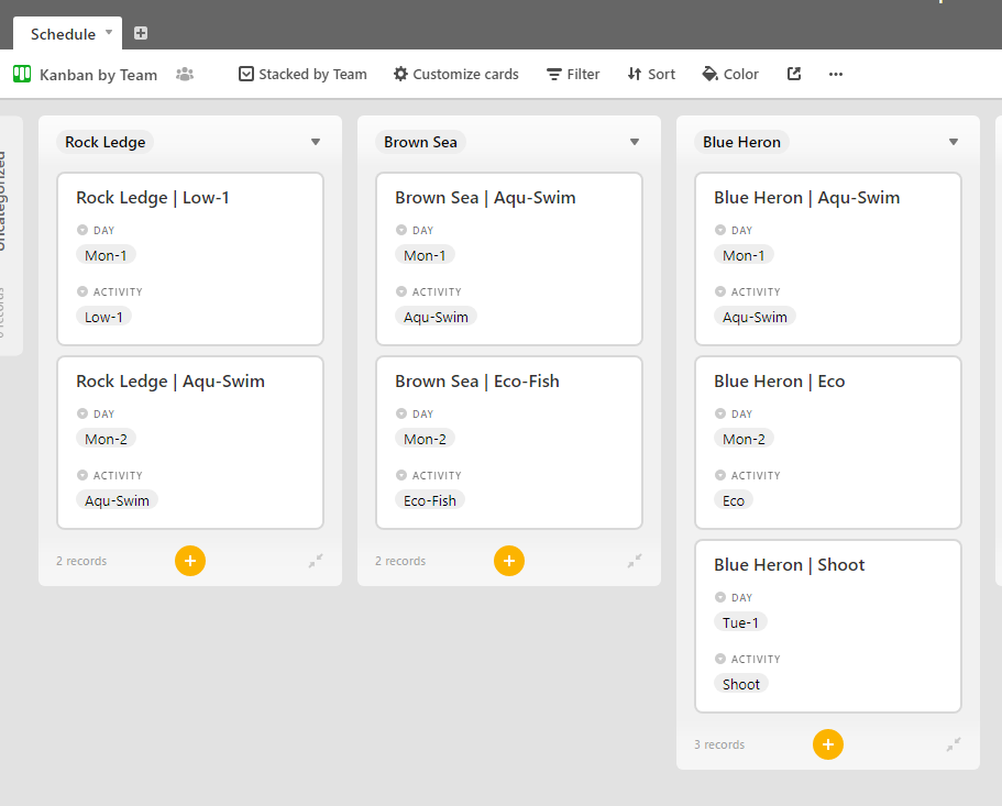

Take Two
Another way you could do this is to have one table with each column representing, Day, Team and Activity.
With this one, your columns (or fields) are single select drop downs.
By doing it this way, you now have the added ability to utilize Kanban view which I think would be of value to you because as things change, you can simply drag and drop the cards from one lane to another.
Anyways, I hope this added some value. Enjoy :grinning_face_with_big_eyes:
