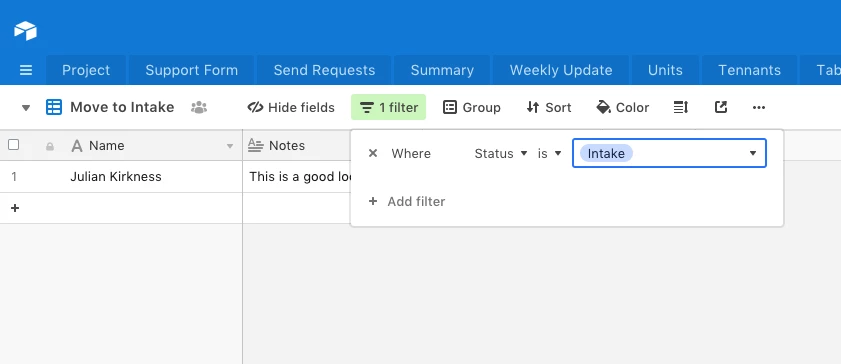

  1. Create a View in your Referral table to filter only those records marked as Intake:

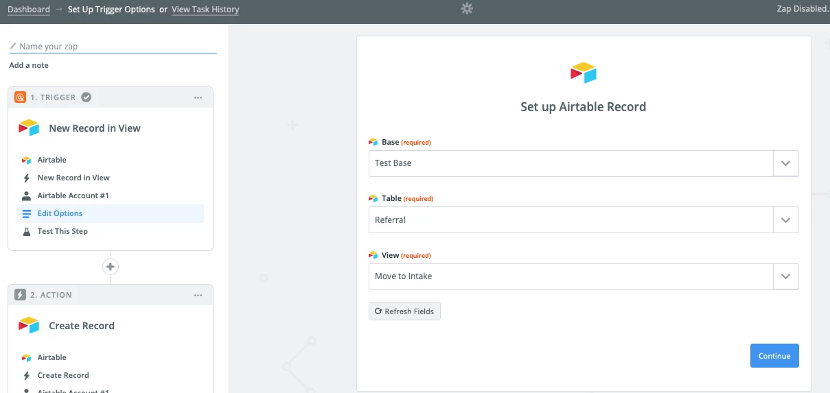

  1. In Zapier Choose Airtable as the trigger app and New Record in View - set it up like this:

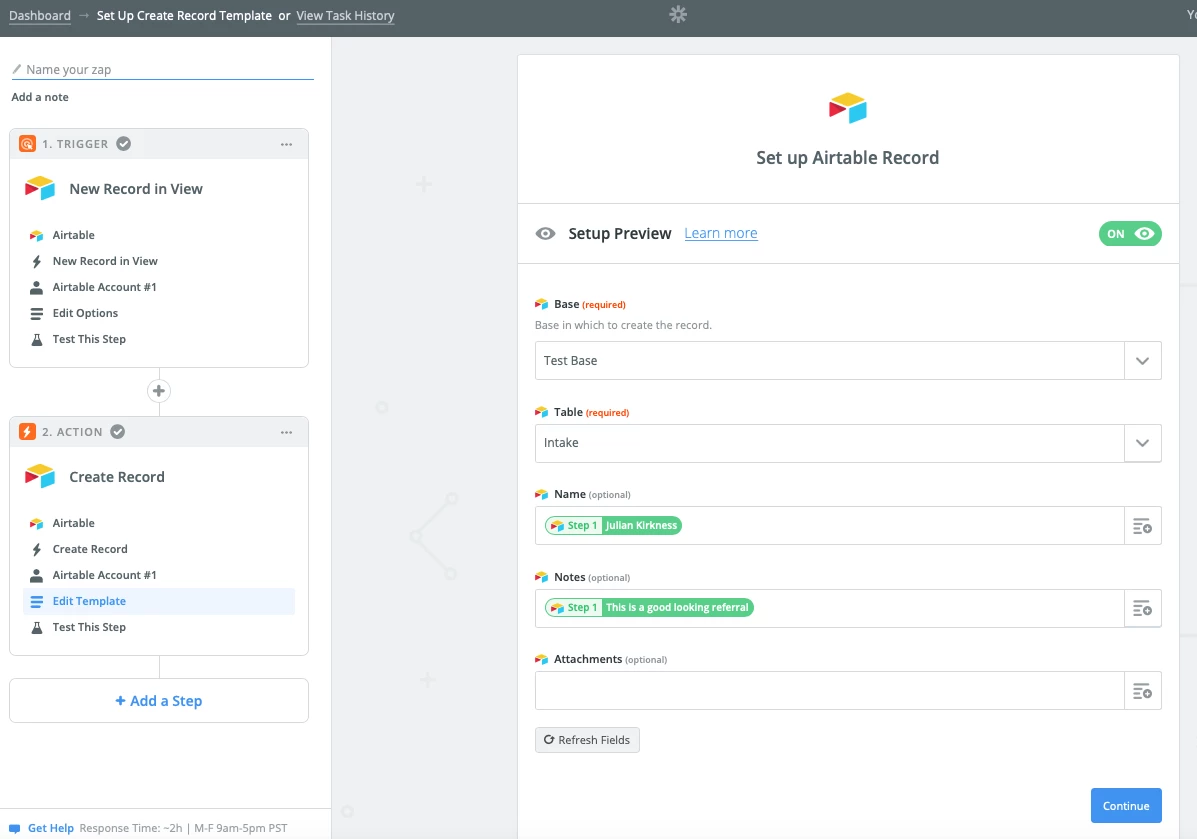

  1. Create an Action Step (again Airtable) - Create Record and set it up like this:
As you go through you have to test each step - so you need to have at least one Referral marked as Intake (and hence in your view).
