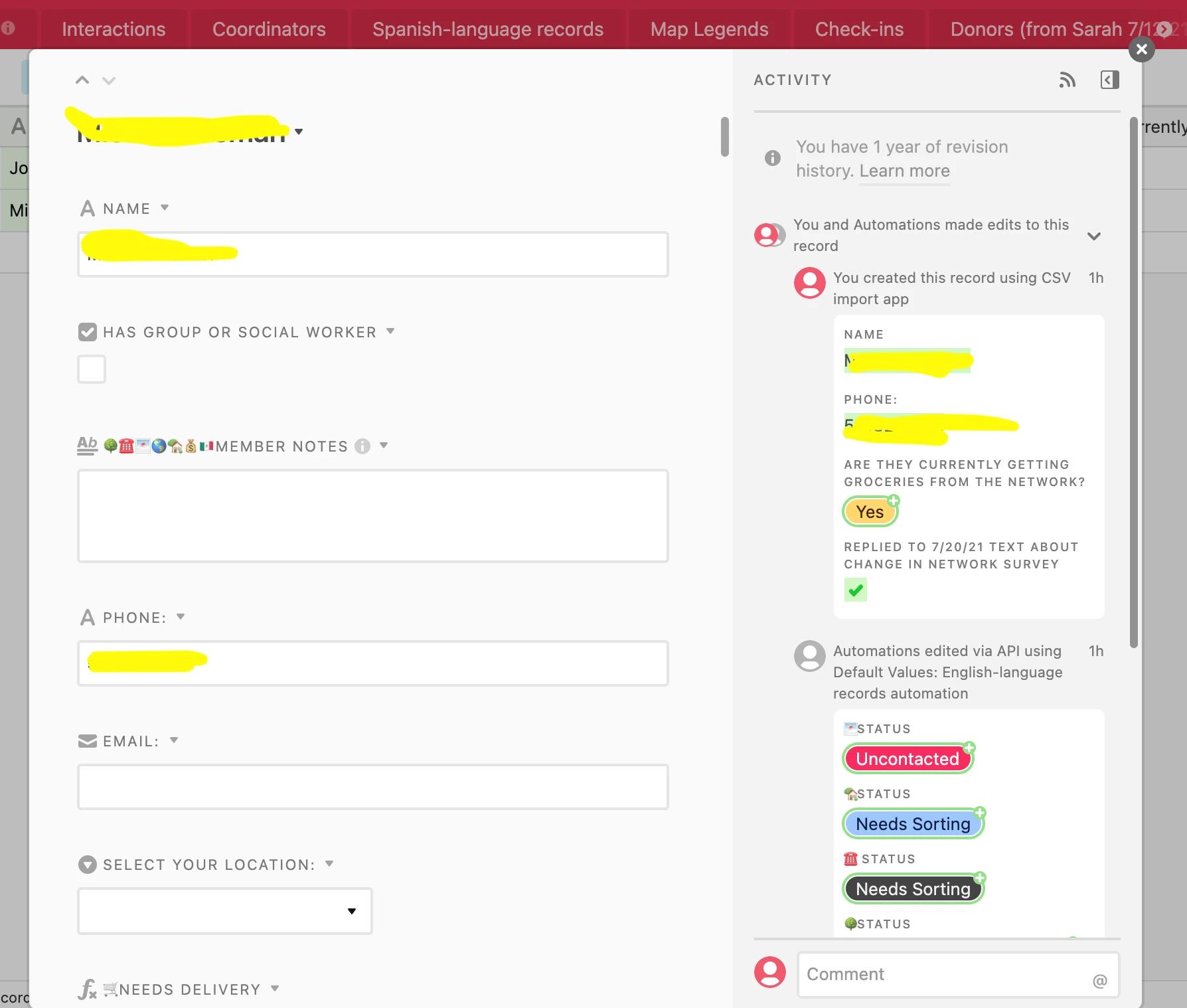

It appears that I’ve merged some records accidentally and lost data.
Is there a way to undo this?
I’m looking at the record history and don’t see the old information, unfortunately. In this screenshot, this record should have more than one hour of history.
(Edited to remove identifying information)

Trying that now with a recent snapshot, but it’s going to undo a lot of stuff, too. Was hoping to just find the info in the merged records.

If my restore works, do you have a suggestion for what to do next?
If the good records are in the restore, what’s the best next step to get them into my existing base? I don’t want to overwrite the whole thing (which I’m not sure is ideal (Restoring a snapshot overwriting the current base? - #7 by ScottWorld)) but I also don’t want to start using the new one, since we have a BUNCH of collaborators and share links on the current one.
