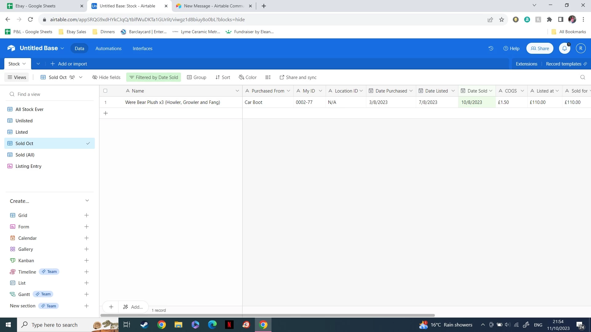

I'm a new user considering upgrading to a paid sub however there is an issue which if not resolvable means Airtable would be completely useless to me.

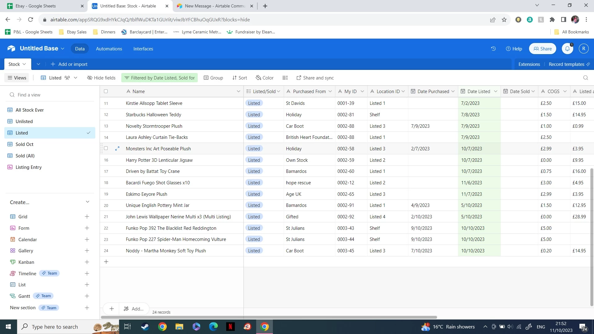

I'm in the UK so using the DD/MM/YYYY format, no problem with this, all the data formats fine.

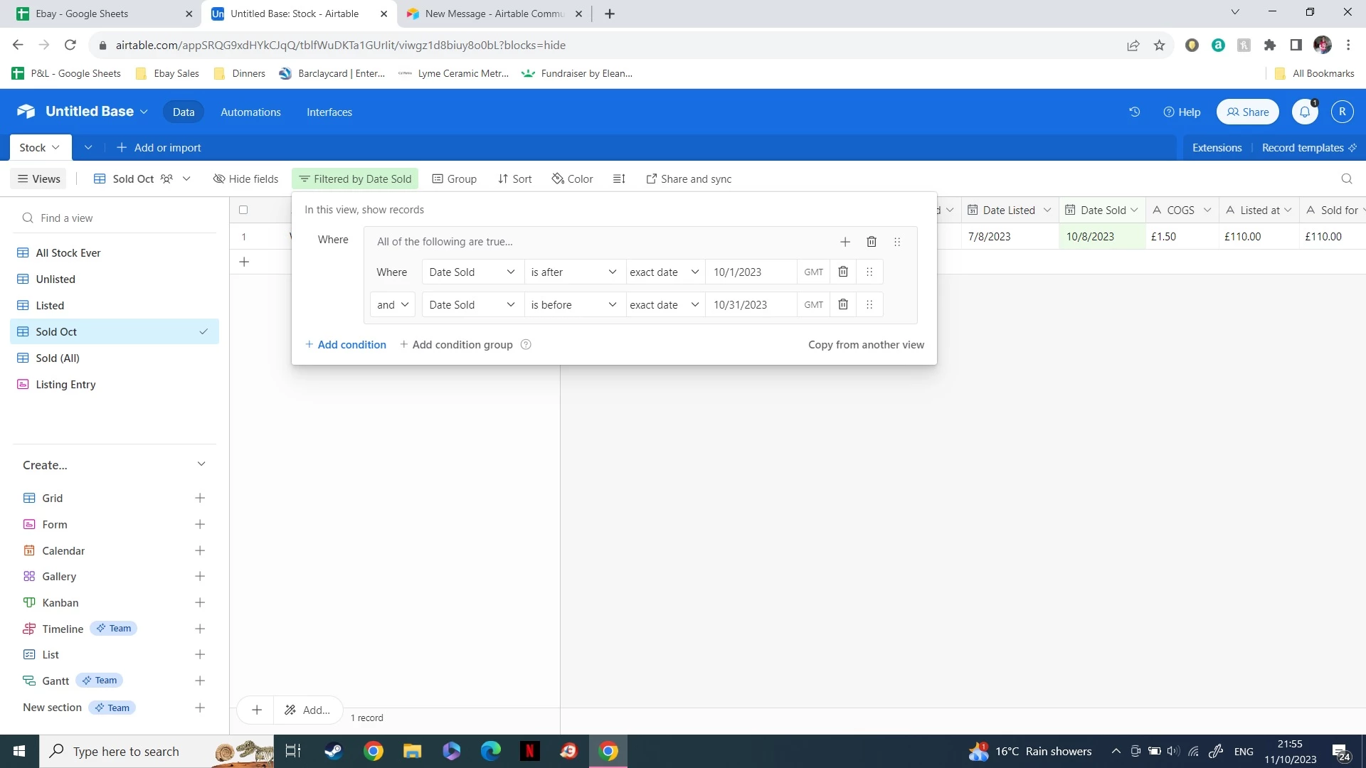

The problem comes when I try to filter view by dates, when I click on the first of October and the 31st of October as the start/end dates for my view, Airtable uses the MM/DD/YYYY format despite all my data being in DD/MM/YYYY format.
Due to this the only entry that comes up was from 10/08/23 (Tenth of August). None of my October sales are visible. If there is no workaround to this then Airtable is completely useless to me.

You've entered your dates in the UK format but unless specified in the field settings, they may not have been acknowledged as such.
Apologies if you've already done this, but on your date fields:
Right click the field name -> Edit field -> Date format -> European
You may then need to re-enter your dates if they've already been acknowledged as US dates as they'll just get jumbled around.
Hope that works!
