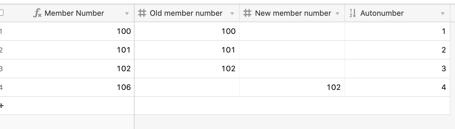

Now in your primary field have a formula:
IF({Old member number}, {Old member number}, {New member number} + Autonumber)
If there’s an old member number this will display. If you get a new member, then the member number will be the “new member number” default plus the autonumber.
I my example, I set the default to be 102, i.e. the max of the existing number. But in fact, I hadn’t thought this through - for continuity it should be the max old number minus the number of old members plus 1 (I think). Anyway you can play around with the default.
As you add more members in Airtable you’ll get this:
