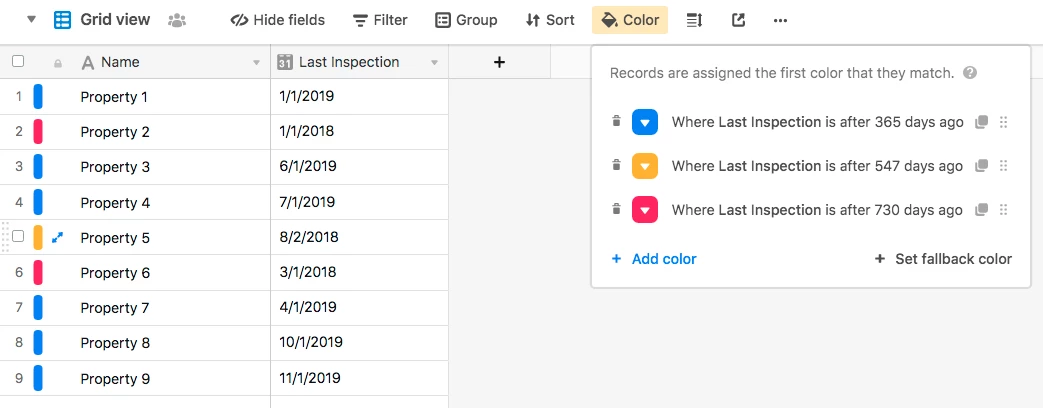

I’m fairly new to airtable, but loving it so far. I manage a program that requires property inspections and reporting on conditions. I’m using Airtable for tracking the properties and various related aspects (contacts, etc).
I just discovered the “color by condition” option, and though that would help give me a quick overview of my inspection statuses. So, i thought setting up conditions for properties inspected within the past year, 18 mo, and 2 years would work. But, this only seems to work for those exact number of days, and I thought I was going to be getting something more like “within the past 365 days”
Thoughts on how I should modify my conditions, or if there’s another functionality I should be using entirely?
Thanks!
6 replies
Welcome to the community, @Jennifer_Robinson! :grinning_face_with_big_eyes: You should be able to get things set up as you wish. Here’s how I set up a quick test:

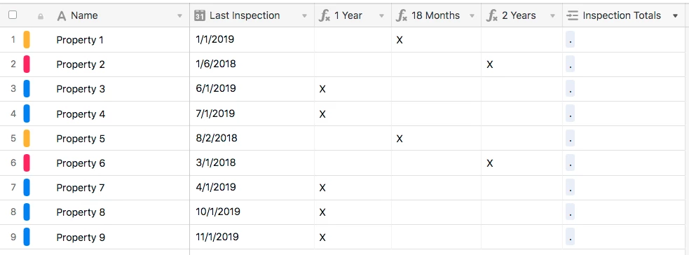

In this modified version, I created three formula fields that simply put an “X” into the field when the date matches specific criteria:

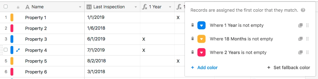

Notice that the marks match up with the colors set previously. With this in place, you can change the color marking system as follows:
The formula for {1 Year} is:
IF({Last Inspection}, IF({Last Inspection} > DATEADD(NOW(), -1, "years"), "X"))
{18 Months} is:
IF({Last Inspection}, IF(AND(NOT({1 Year}), {Last Inspection} > DATEADD(NOW(), -1.5, "years")), "X"))
And finally {2 Years}:
IF({Last Inspection}, IF(AND(NOT({1 Year}), NOT({18 Months}), {Last Inspection} > DATEADD(NOW(), -2, "years")), "X"))

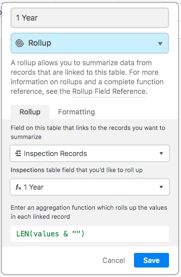

Here’s a screenshot of my first rollup for 1 Year. The rest are virtually the same, just pulling from the other appropriate fields.
To break down the aggregation function, values is an array containing data from the specified field—in this case, {1 Year}—across all linked records. Because of the formula we made, only those records matching that formula’s criteria will contain the X, and the rollup operation will ignore empty fields, so for this example rollup values will be an array of five Xs. Concatenating that with an empty string using the & operator turns the array into a string of five Xs, and then the LEN() function returns that string length as a number.
