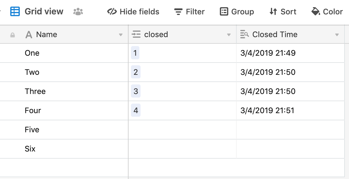

Let’s say my main table is this:

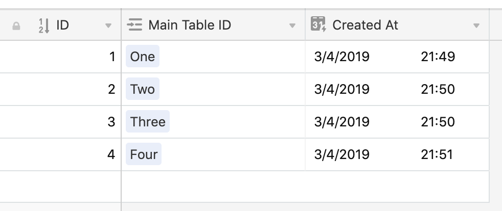

When I want to close, say, record “Five”, instead of checking a checkbox as you describe I create a record in my linked second table via the link modal window in the first table. This is my second table:
The “closed” field in my first table is linked to the second table and the “closed time” in the first table is a lookup to the “created at” field in the second table.

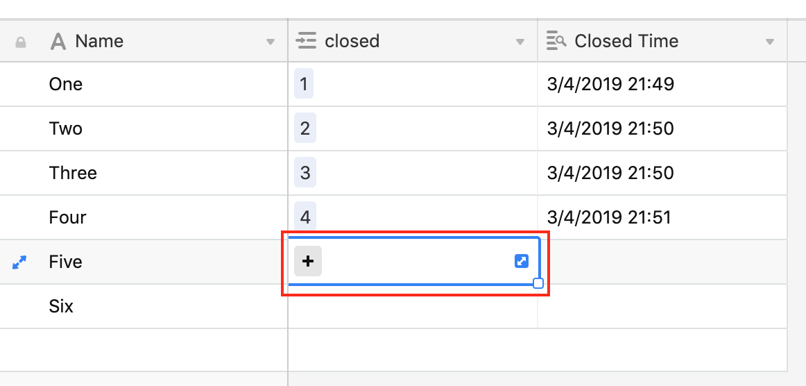

So, to close record “Five” I click on the linked record as shown:

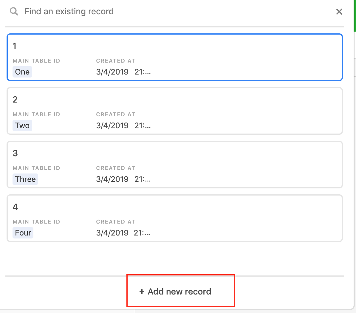

When the modal pops up I don’t select one of the existing records, but always create a new record:
This new record will be created with its created time and the created time is pulled through to my first table where I name it the closed time.
