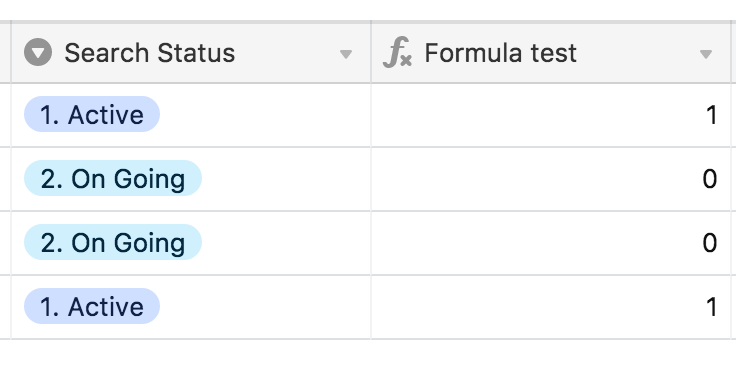

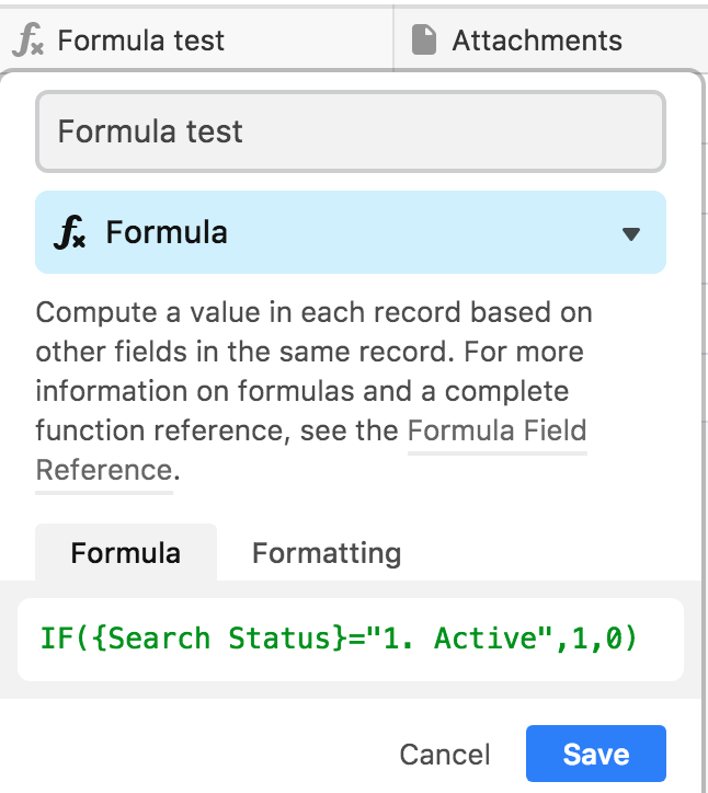

Hi Javier
I’ve modified my field names to be the same as your’s and it’s still working - here are screenshots:
and the formula:
If this doesn’t help can you share your base (read only) or some screen shots?

I think the problem are the quotes. People copy from the forum instead of understanding and build the formulas themselves :roll_eyes:

Hi Javier
and the formula:
Works great! Thank you for that simple solution – and clearly explained.

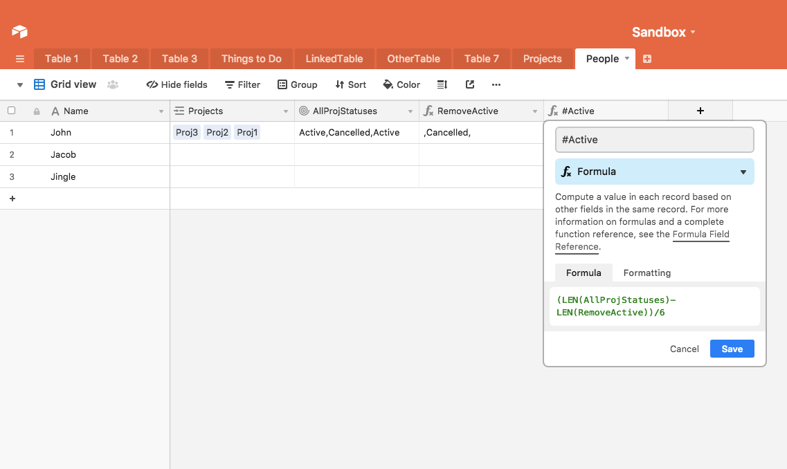

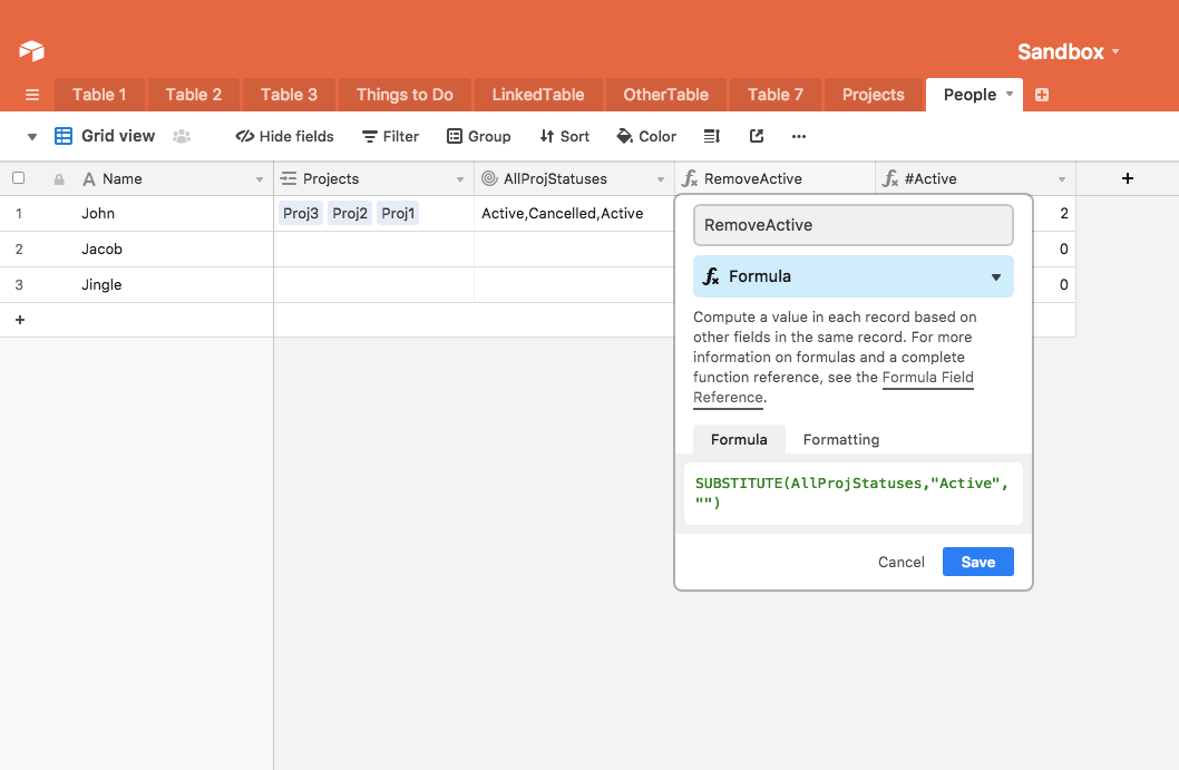

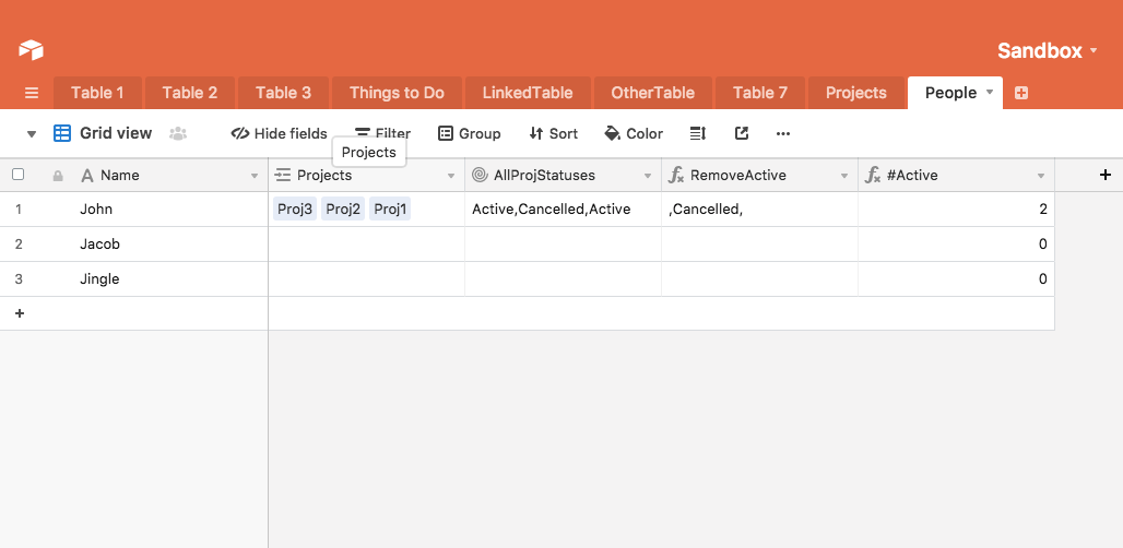

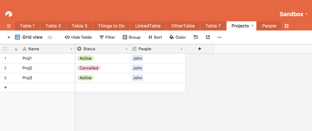

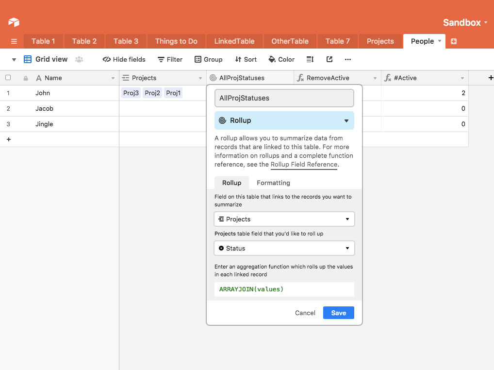

Working from the same example @Elias_Gomez_Sainz was working with, you have:
  • Project records with a “Status” field with the 3 Single Select options
  • Another table, “People” that link to Projects
  • A person may have many projects
  • A rollup field in the “People” table that has
Projects
People
Rollup
Remove Active Projects
Compare Length of Strings and Divide by Length of the Word "Active"
Hide any fields you don’t need to see and show only the #Active field.
