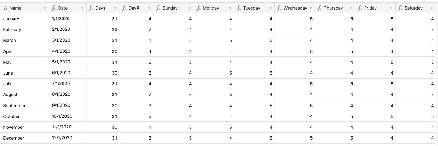

Thanks for the detailed explanation, @Meredith_Rimmer! That was very helpful, as was the link provided by @ScottWorld. It sounds like what you need, Meredith, is exactly what that FileMaker user shared, and thankfully the FileMaker formula syntax was fairly easy to grasp, so I was able to convert the whole system to Airtable’s structure.
Here’s a breakdown:
I began with the month names in the primary field, and used a formula in the {Date} field to give me the first date of that month for the current year:
DATETIME_PARSE(Name & " 1, " & YEAR(TODAY()))
The {Days} field calculates the number of days by taking the difference between the current month’s first date and the first date of the next month:
IF({Date}, DATETIME_DIFF(DATEADD({Date}, 1, "months"), {Date}, "days"))
The {Day#} field indicates where the first day of the month falls on a simple 1-7 scale (Sunday = 1, Saturday = 7). This was an easy tweak using Airtable’s built-in WEEKDAY() function:
WEEKDAY({Date}) + 1
The rest of these formulas do the dirty work of figuring out how many iterations of each weekday there are in that month. Whoever wrote that original FileMaker formula series must’ve had fun (or had help) figuring out the pattern, but it’s a pretty basic pattern when you break it down. In your case, all you need are the formulas for the {Monday} and {Thursday} fields, but I’m listing them all here for posterity.
Sunday:
IF(AND({Day#} = 1, Days >= 29), 5, IF(AND({Day#} = 7, Days >= 30), 5, IF(AND({Day#} = 6, Days = 31), 5, 4)))
Monday:
IF(AND({Day#} = 2, Days >= 29), 5, IF(AND({Day#} = 1, Days >= 30), 5, IF(AND({Day#} = 7, Days = 31), 5, 4)))
Tuesday:
IF(AND({Day#} = 3, Days >= 29), 5, IF(AND({Day#} = 2, Days >= 30), 5, IF(AND({Day#} = 1, Days = 31), 5, 4)))
Wednesday:
IF(AND({Day#} = 4, Days >= 29), 5, IF(AND({Day#} = 3, Days >= 30), 5, IF(AND({Day#} = 2, Days = 31), 5, 4)))
Thursday:
IF(AND({Day#} = 5, Days >= 29), 5, IF(AND({Day#} = 4, Days >= 30), 5, IF(AND({Day#} = 3, Days = 31), 5, 4)))
Friday:
IF(AND({Day#} = 6, Days >= 29), 5, IF(AND({Day#} = 5, Days >= 30), 5, IF(AND({Day#} = 4, Days = 31), 5, 4)))
Saturday:
IF(AND({Day#} = 7, Days >= 29), 5, IF(AND({Day#} = 6, Days >= 30), 5, IF(AND({Day#} = 5, Days = 31), 5, 4)))
Thanks again to @ScottWorld for sharing that link! I would probably be banging my head on a much more involved setup if it weren’t for that.

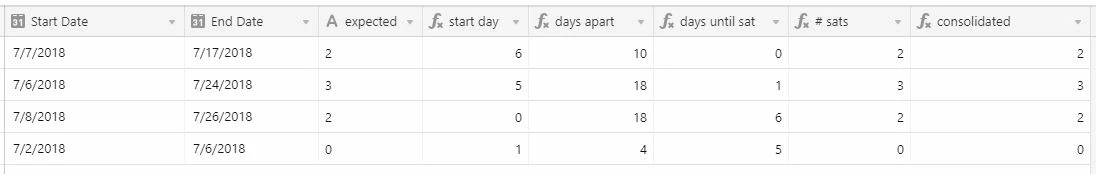

A while back, I needed to figure out how many Saturdays were in a given time frame. I posted about it and a user named @Tyler_Kurlas came up with this insane formula:
ROUNDDOWN((1+(DATETIME_DIFF({End Date},{Start Date},'days')-(6-WEEKDAY({Start Date})))/7),0)
The above calculates how many Saturdays fall between two dates. It can be adjusted for different days of the week by changing the “6” to the corresponding day of the week’s value (0-based, starting on Sunday). He included a detailed breakdown of how it works (link below) - but I am honestly still trying to wrap my head around it. Kudos to you, Tyler!
Thought it might be helpful here :slightly_smiling_face:
Super creative solution, @Justin_Barrett! :slightly_smiling_face:

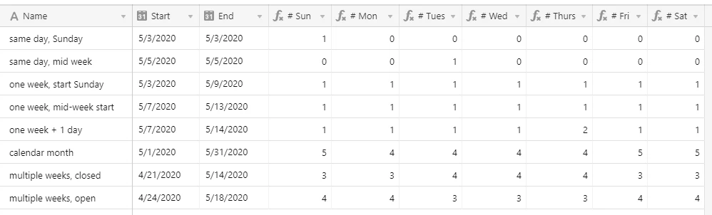

So, I wanted a solution to this issue that would work for any start and end dates (as long as the end date was on or after the start date).
This is what I came up with.
My formula checks for the number of whole weeks, and then adds one if the day of the week is included in the partial week left over.
The number of whole weeks is easily determined by using DATETIME_DIFF(End, Start, 'weeks')
The partial week left over is a bit harder to determine. There are two situations: where the leftover days are all in the same week, and where the leftover days are split across two weeks. This formula calculate if the desired weekeday is included in the leftover days by evaluating the WEEKDAY() of the start and end dates for those two situations.
In the formula below, replace DesiredWeekday with the number for the day of the week (Sunday = 0, Monday = 1, …)
  AND(
    WEEKDAY(End) >= WEEKDAY(Start),
    WEEKDAY(End) >= DesiredWeekday,
    WEEKDAY(Start) <= DesiredWeekday
  1
  AND(
    WEEKDAY(End) < WEEKDAY(Start),
    OR(
  1
@Meredith_Rimmer As you can see, there are multiple possible formulas for answering your question. If you find a formula that works for you, could you please mark that one as the solution? This will help anyone reading the thread sift through the different answers.
If you don’t find a formula that works for you, could you please give a bit more details and a screen capture?
