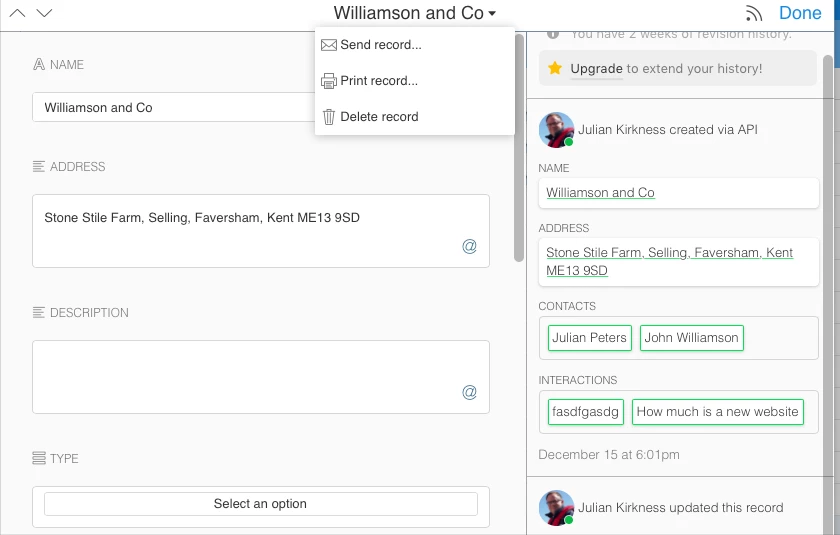

You can’t quite do what you’re looking for at the moment with Airtable forms (they are input only). It would be able to share a form for a particular record with someone but this isn’t possible.
The best I can come up with is this process:
a. First send the (group) record to the person (I am using the example of a Company in a CRM base:
b. Add your message in the Send dialog:
c. This sends an email to the tutor (in your example) with a link to see the record in Airtable (at the bottom of the email):
d. Clicking the link takes the person to Airtable in a browser and opens the particular record in Expanded view:
The downside of this is, of course, that the person would have access to everything else in the base as well!
Maybe someone else has some ideas - and wouldn’t it be great to be able to share an edit form with people!
Hope this helps a little?
Julian

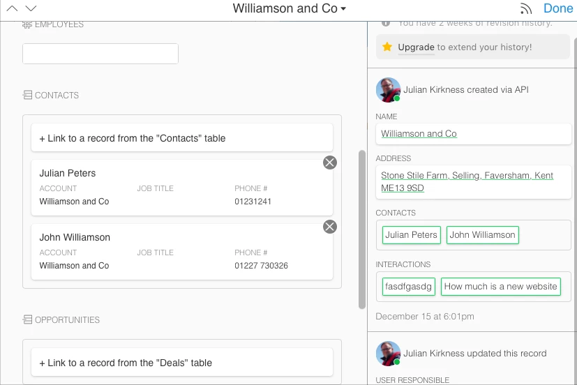

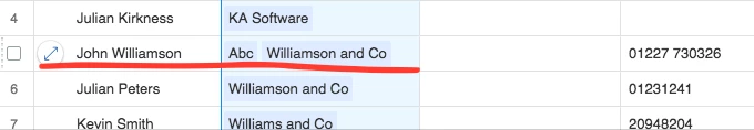

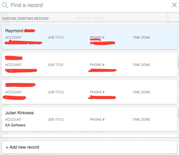

Hi Luis
I am not sure I follow this - if I try to add a contact to my Companies table:
Then the contact is NOT duplicated in the Contacts table - but could show as being connected to two or more companies:
In this case John Williamson is linked to companies Abc as well as Williamson and Co.
It would be interesting to see a screen shot of what you mean?
Julian

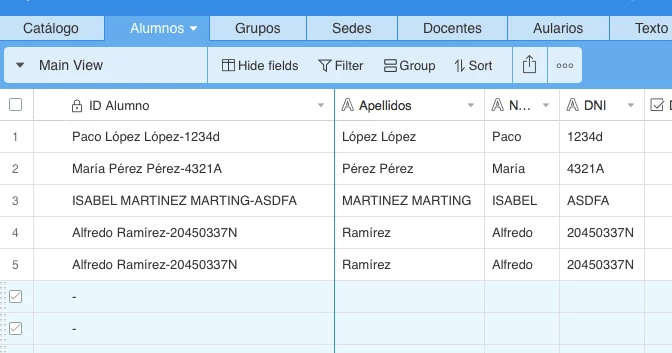

this is what I mean. The ID Alumno is a formula made up with apellidos, nombre and DNI (national identity card number)
Hi Luis
I still don’t really understand what you mean - I can see that the Apellidos field appears to be duplicated but I can’t see why.
Is there a way you could share a link to a copy of your base so that I (and others) could have a look?
(I suggest a copy so that no one messes up the original!)
