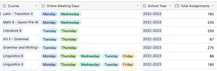

I have a table of student-courses with these key fields:
(In my example here, the Courses are in a separate table, and in this table they are joined with a Student, which is why you see the Course as a linked record here)
So this defines an instance of each course for a particular school year (2022-2023), and the days this instance of the course meets on. My script doesn’t use the meeting days field – instead, my script is using the “Total Assignments” field to create assignment due dates for the classes that are spaced out across the school year.

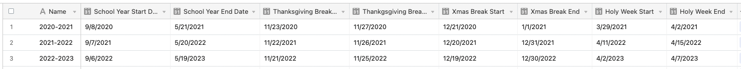

In the School Years table, we have defined some key dates for our Script to work with when plotting out the schedule, and each year when we create the new school year record, we provide the values for those key dates.
The script below will take those dates into account when creating lesson records that are spread evenly across the school year (from start date to stop date), but never on school break weeks. You can do something similar to create course meeting records on specific days (using a similar “Meeting Days” field). Also of note, this script is pulling in an external JavaScript library called moment.js to make working with dates easier… so a lot of the date-oriented code here relies on the presence of that library).
