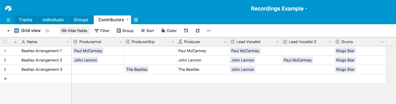

I want to be able to select from Individuals and Groups in a single list in another table:
e.g.
Paul McCartney
John Lennon
The Beatles
I have created a table called Contributors, but I can’t worked out how to combine records from Individuals & Groups
Is this possible?
It isn’t possible to reference to different tables (Individuals & Groups) from a single “Linked Records” field.
I’m not totally clear on the structure of your database, so I’ll do my best to word what I see as potential solution sin a way that I think will fit into what you are doing there…
1 solution is:

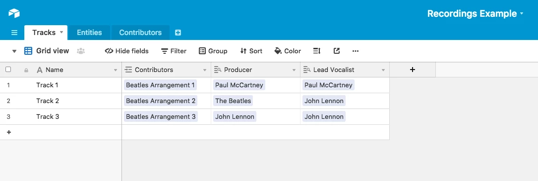

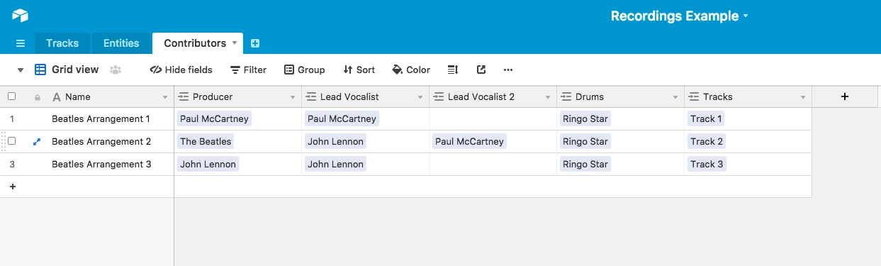

In your Contributors table - which it looks to me like you are linking to a Track record - you could create another field that checks which of the two has been selected for a particular role, and fills with the one that has been selected. It means 3 fields in place of one in the Contributors table, but ultimately you can do a Lookup on only the 1 “Producer” field from the Tracks table, so the Tracks table will still only show one field for “Producer”:
Another solution is:

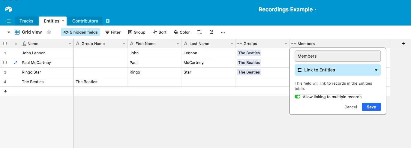

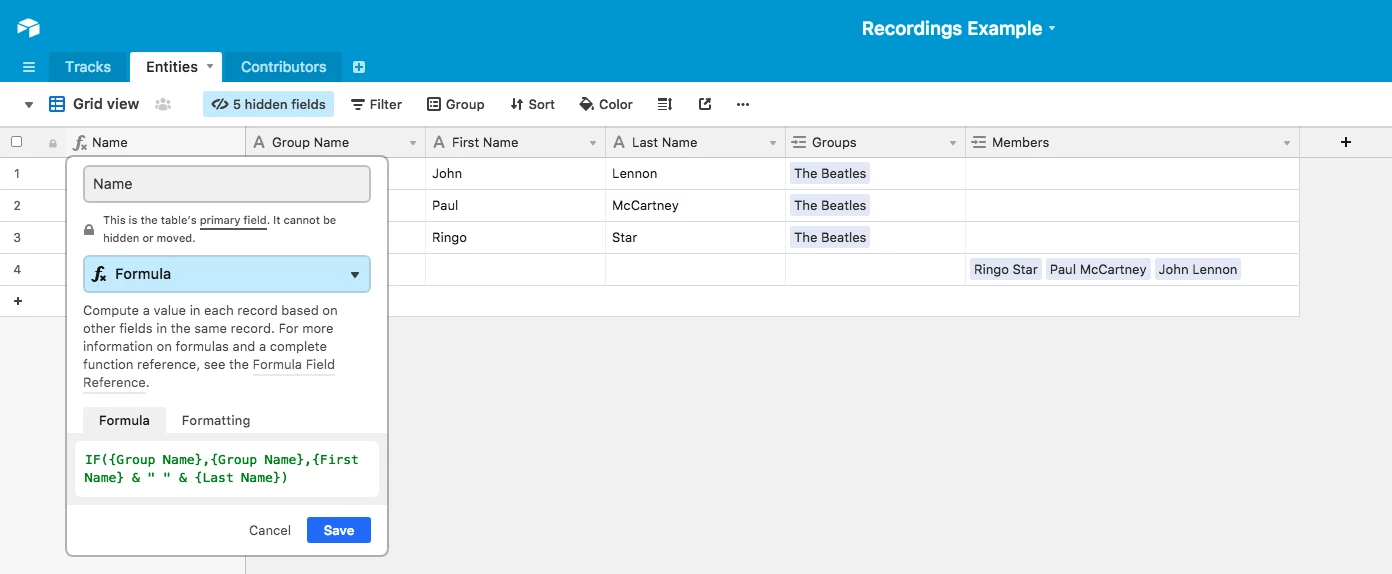

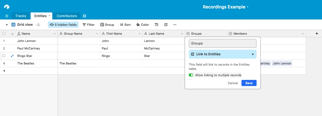

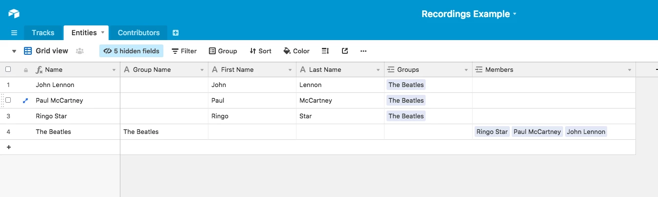

Collapse your Groups table into the Individuals table (and perhaps rename the amalgamation to Entities to make it more clear). Create self-referencing links within the table to define groups, and add a “Group Name” field. the “Name” can display “Group Name” if it exists, otherwise “First Name” and “Last Name”; this resolves the problem of multiple “Producer” fields in the “Contributors” table, but makes “Groups” less dynamic as an entity:
Neither solution is a golden bullet, but one might get you where you want to go… :man_shrugging:

Hi Jeremy,
Option 2 solves the problem perfectly. Thank you for taking time to answer my question. Really appreciate it!
