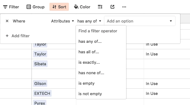

In your Publications table (the table in your database that holds all of your “tagged” publications) you would create a view that filters to show only those records that contain the tag “20-inch flume”. The “filter” menu in a view allows you to request only a subset of records to be shown in that view, so you are saying to the table, "Show me all records where Tags --> has any of --> 20-inch flume.

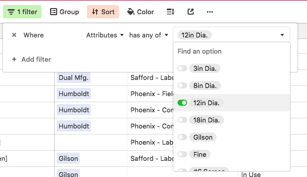

I do something similar in an equipment database I keep. I use a multi-select field to “tag” equipment with {Attributes} that item might have:
Once that filter is in place, the view of my table I am in will only show records that have the “12in Dia.” Attribute tag.

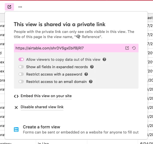

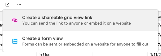

The next step is to share only that view, by using the share menu:

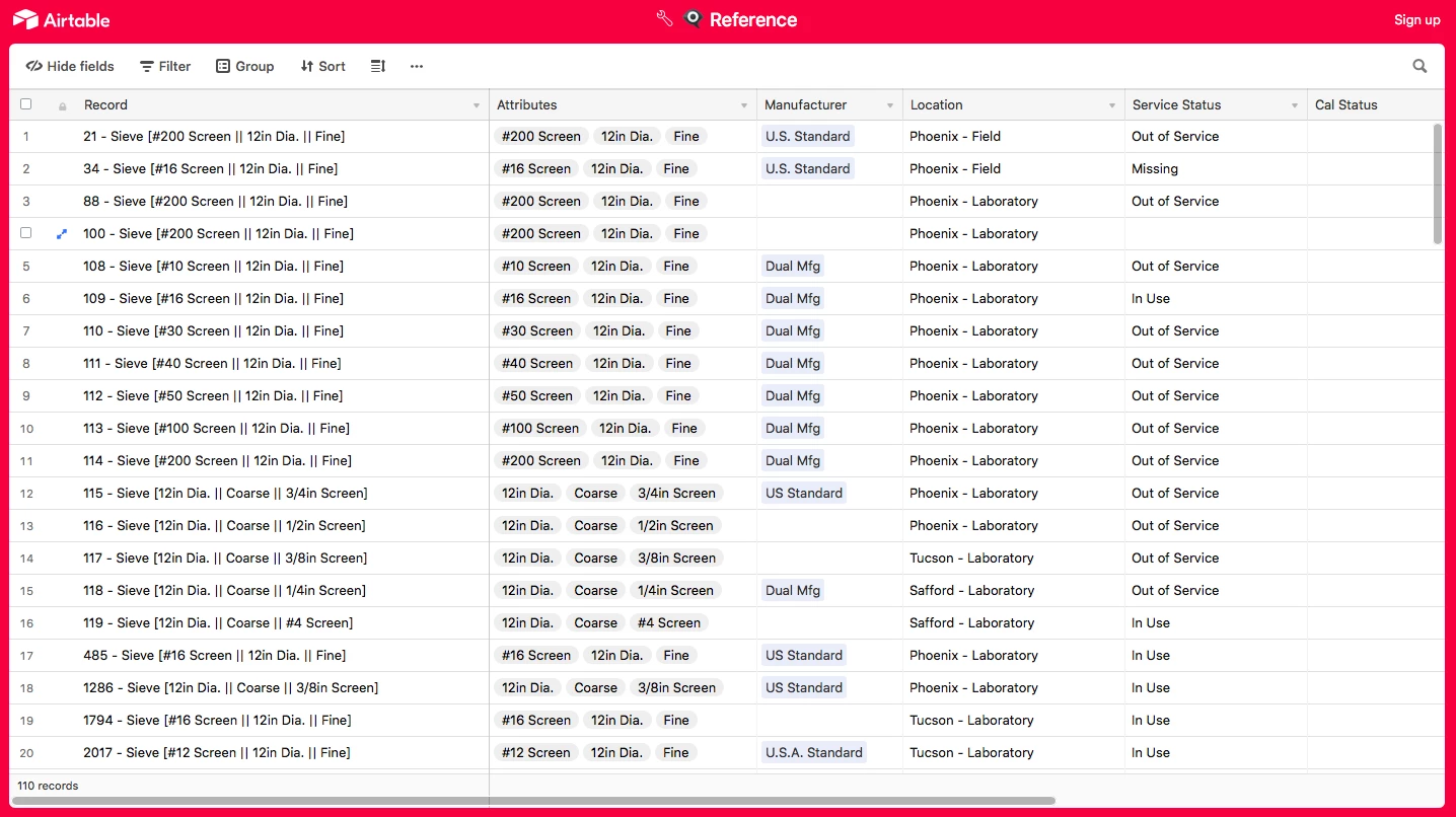

If I were to embed this view I just created in a website (or put a link to it in a website), the people who visit it will have no access to view any records other than those with the “20in Dia.” tag, as you can see here:
(I have well over 5,000 records in that table, but only 110 are visible in this shared view, and the others cannot be accessed in any way from this shared view)
