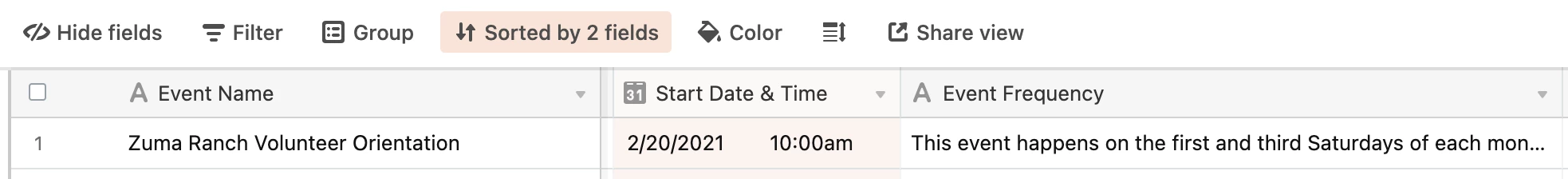

We have volunteer events that we need to reoccur on specific days of the month. For example, Zuma Ranch has volunteer orientation on the 1st and 3rd Saturdays of every month. How can I automate the date to update to the next Tuesday it will happen so the date updates on the listing? Any ideas would be greatly appreciated!!!
