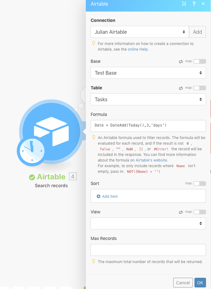

Hi @Eliza_Salmon
To answer the specific question about Integromat, you would use a Search Record option looking something like this (for the 3 day test):
Note that the Formula uses Airtable’s formula syntax.
Whatever you want to do next would then run for each record which matches the criteria. It’s even fairly simple to group together records so that a person could get a single email listing all tasks due that day.

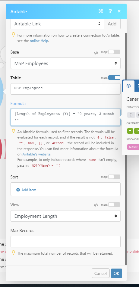

Hey @Julian_Kirkness ,
I’m trying to do something very similar with Integromat where I am alerted by email when certain employment length milestones are hit, see image below. It keeps saying Formula invalid but it appears to be correct, what am I missing? Field is Employment Length (Y) and I want the trigger to be once the field (which is a calculated formula field) says “0 years, 3 months”.

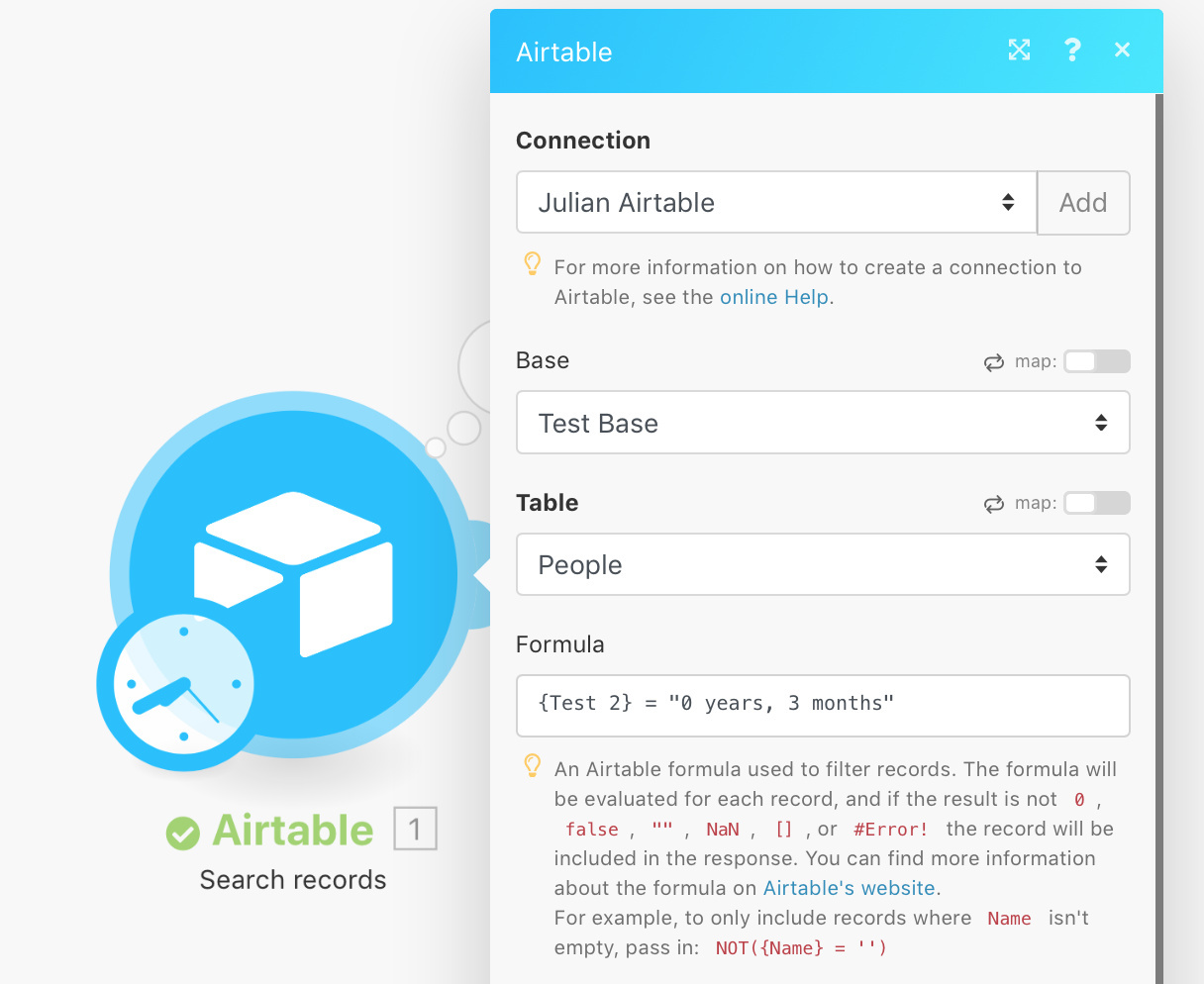

Hi @Scott_Lusignan
Just tried a similar search:
and it worked as expected - I even tried changing the field name to {Length of employment (Y)} and it still worked (I wondered about the brackets in the field name). Have you checked you don’t have a typo in the field name?
Hi @Scott_Lusignan
@Julian_Kirkness
Wow, embarassing. I shortened the field to make it simpler and it must have been something where I missed a parenthesis . Thanks again Julian, brilliant as always.

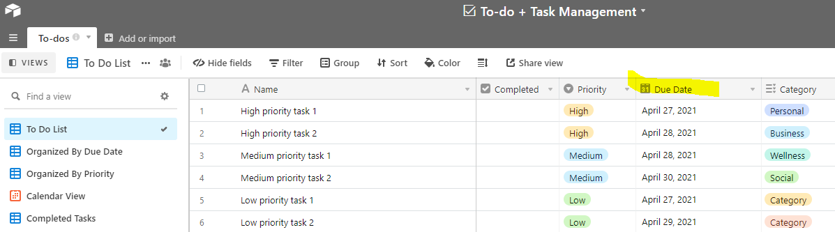

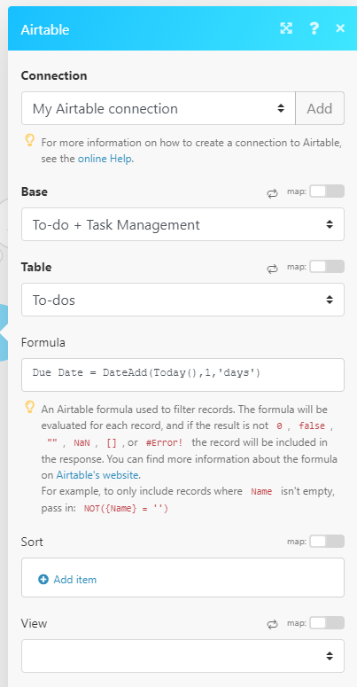

  • Apr 27, 2021 4:23 AM UTC
Hi I’ve been searching on an automation to send email for reminders - but it seems i am getting a formula error “The operation failed with an error. The formula for filtering records is invalid: Invalid formula. Please check your formula text.”
and can’t figure out what i am doing wrong :frowning: Can anyone advise?
