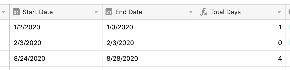

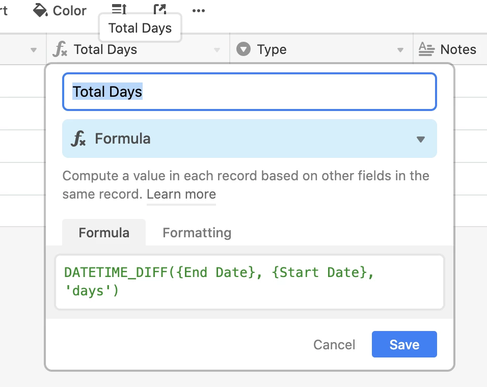

Hello–I have a simple question that I am struggling to solve. I am trying to calculate the difference between two dates but I need it to count full days. For example in the first record Start date of 1/2 and end date of 1/3 needs to equal 2 and not 1. The same with the 3 record–I need a formula that will calculate this to be 5 and not 4.

Best answer by ScottWorld
Just add a +1 to the end of your formula! :slightly_smiling_face:
