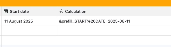

How would you add the IF({date field} statement to this line… Because of the prefill this fix below is greying out my URL button for any record that has a blank date..
 CONCATENATE(
        "&prefill_" & ENCODE_URL_COMPONENT("START DATE"),
        "=" & ENCODE_URL_COMPONENT(DATESTR({START DATE}) & "")

Try this
{Start date},
CONCATENATE(
"=" & ENCODE_URL_COMPONENT(DATESTR({Start date}) & "")
  • Aug 13, 2025 3:41 PM UTC
Thank you!!!!
