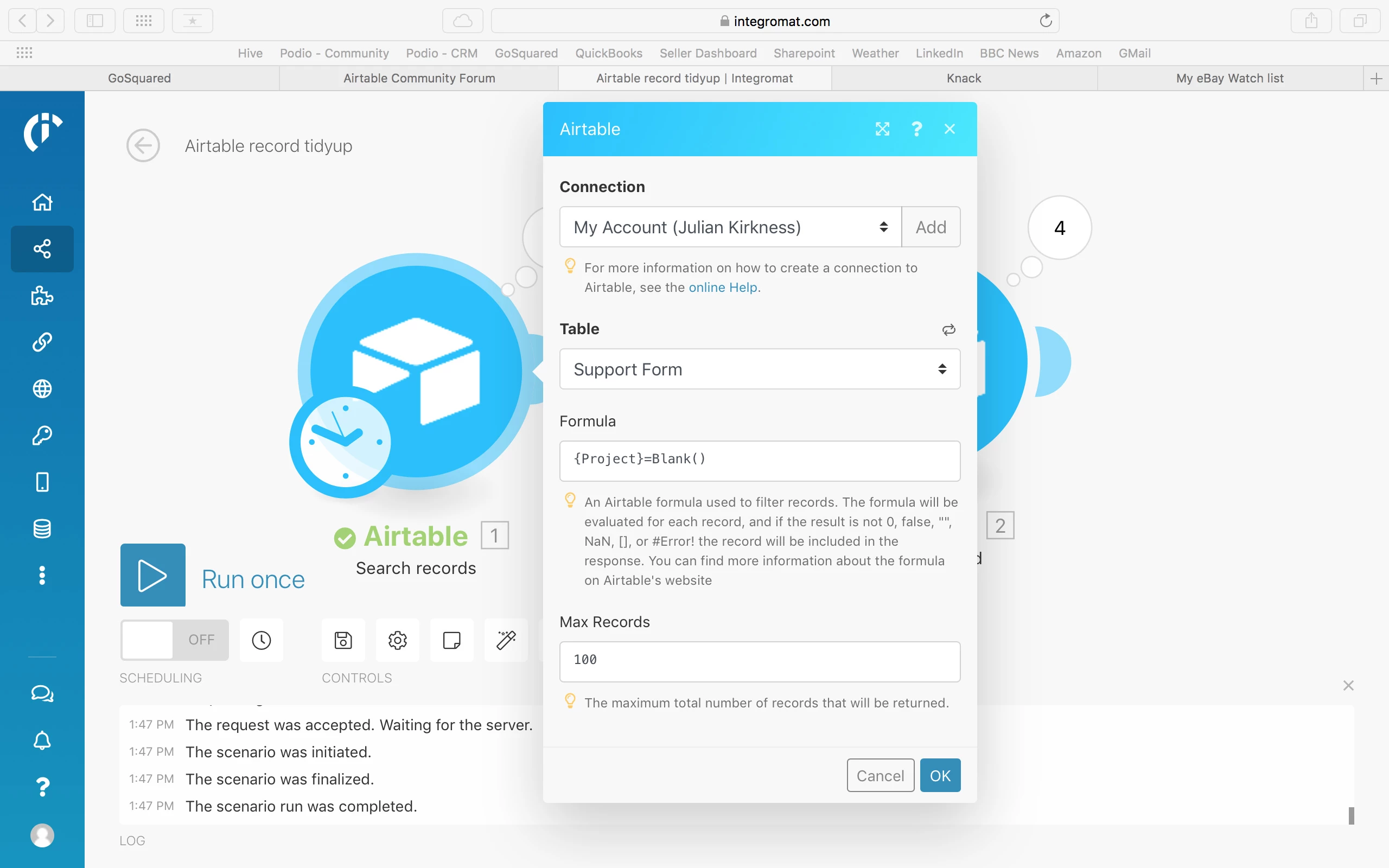

Unfortunately, Zapier cannot delete Airtable records (and there isn’t a trigger on deletion of a record either).
However, it can be done with Integromat (more powerful tool like Zapier) - albeit not as the parent record is deleted. You can run an Integromat “Scenario” as often as once a minute so there’s not much delay.
Here are the two steps in the Scenario:
1. Find Records with Blank Link Fields:
2. Delete the records found:
The great thing here is that it will process multiple records at one (you can specify how many) - the single find step may find 50 orphaned records and these would all be deleted.
The only issue is that designing Integromat Scenarios with Airtable is a little bug ridden at the moment (once they are designed it all works though). Airtable and Integromat need to put their heads together and sort this out.

@Julian_Kirkness
I have a "Customer/Invoice /Product Line/Products database.
When I deleted the Invoice, the associated Line Items were not deleted.
So I tried your suggestion, and it worked like a charm!
Thanks man, I really appreciate your sharing of your knowledge.
