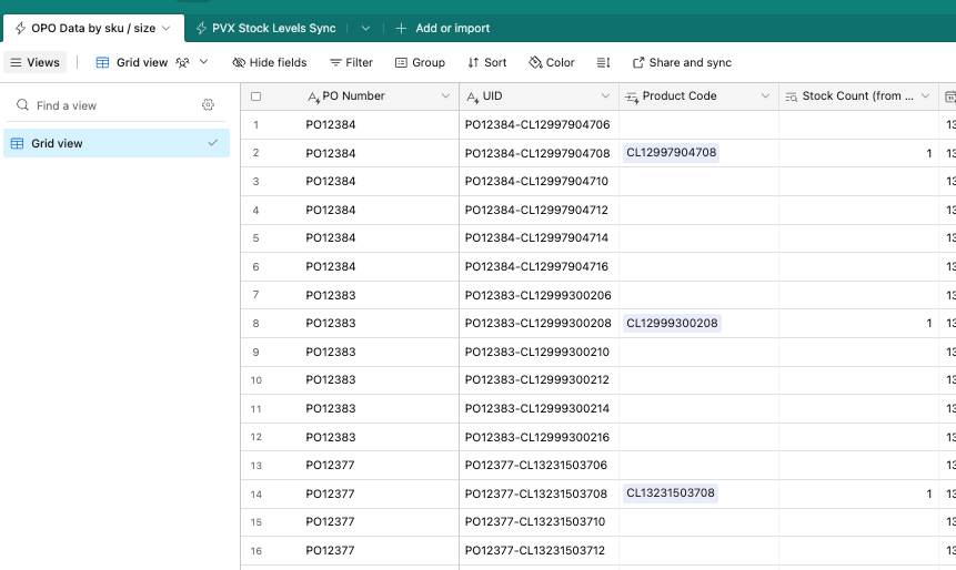

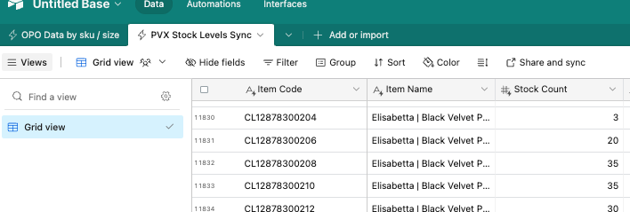

Example below, table 'Opo Data...' I am trying to use the 'Product Code' as a lookup to the 'PVX Stock Levels'. It shows the value when it finds a match, but when it does not find a match it's blank.
The field was originally populated by a script in node as a single line text. I've converted to link to the stock table.
Why does the value disappear when no match found and is there a way to prevent this behaviour.

In usual table, if no match, it will create new record with new value and link to it.
On your screenshot, you have two synced tables. They are read-only (unless you have Enterprise two way sync, but I think even in this case linking cannot auto-create new records). The same behavior, when during bulk-linking new records cannot be created, happens when the primary field is a formula. Or when table-level permission set as 'Create new records' switched from "Editors and up" (default) to "Nobody" (for example).

So there isn't really a way round this with linked fields?
Maybe an automation to copy the value into a new field that is a single-line text to hold the original value, for reference when a link not found?
