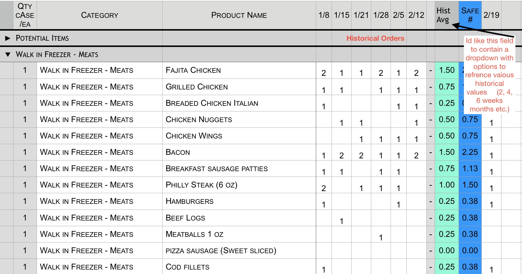

This is a screen shot from the spreadsheet I am using currently to perform this operation. Hopefully this helps illustrate what I am trying to do. What I need is more flexibility when calculating historical averages depending on the type of product I am dealing with. Additionally Id like to archive the previous orders after the last 4 most recent so that the sheet doesn’t get out of control. Thanks so much for helping me with this. :slightly_smiling_face:

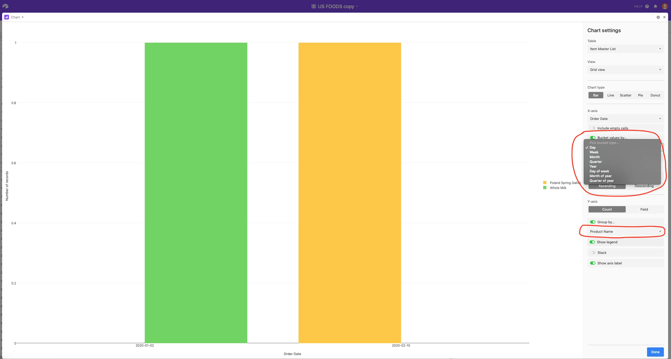

Ok now for your sheet, I think you need to do the following:
  1. You need to have 1 sheet for orders. This will contain all the orders you do, it should include at least the item and the date of the order.
  2. If you are on the Pro Plan, you will be able to have a Graph like the attached screenshot, this can be utilized to group items by whatever category you want.
  1. If you do not want to invest at the moment in the Pro Plan, you will need to have 2 Fields. One would be Duration to Date and the other would be something like History Category. I have made that in this sheet. https://airtable.com/invite/l?inviteId=invhjeEtET7NSf2qQ&inviteToken=41e795e8dce823f8423e0ae40d35208888cc6820487716a407ca7116adb7f255 (this is a view only link, feel free to copy this base into your own workspace so you can play around with it).
The Formula i put in the History Category field, is a very simple formula that you can change to your own needs.
  1. Now that you have this field, you can Group (not filter) by 2 Fields, one would be this History Category and the Other would be Vendor. (already did it in the above base for you to check it).
Is that close to what you were thinking of?
