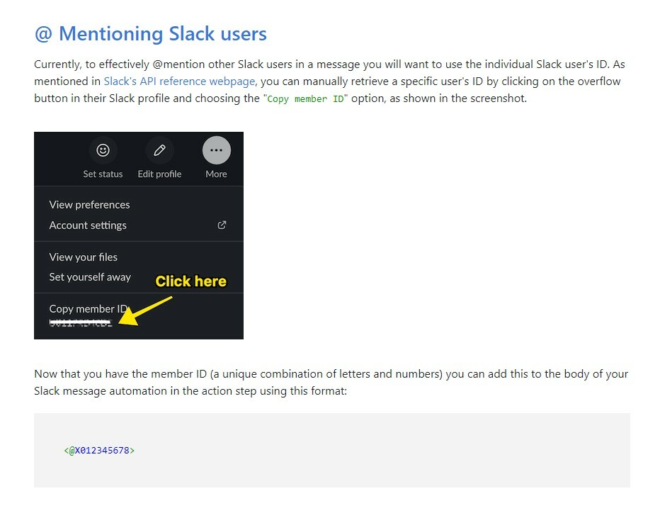

When you say “ID”, do you mean the Slack username or the unique Member ID? I was surprised to find out that you can’t just send @[username] from Airtable to tag users in Slack.
Buried in Airtable documentation (Send a Slack message Action – Airtable Support) is a hint on how to accomplish this:
Once you find each user’s Member ID, you should be able to add these to your Roster table, and should be able to tag team members using the format <@[Member ID]>.
It sounds like you may have already tried this though. If you’ve tried this and it doesn’t work, what does the output look like in Slack?

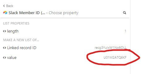

Hmm that’s very odd. I just tested it again and it worked for me. Maybe a silly question, but when you add the Trigger value above, are you able to see one of the Slack Member IDs from the trigger test before you add the variable? Picture included to show what I mean:
When I test the automation out with a blank variable, I see the same output as you (<@>). Your syntax above looks correct to me, so I’m thinking for whatever reason it’s not reading the variable you’ve selected, or is reading it as blank.

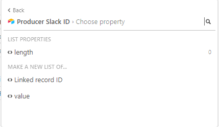

You’re totally right, mine is blank:
I have no idea why. It’s a look-up field from a different table, but the field type in that table is just single line text, and the look-up is displaying in the table just fine:
Is this potentially a bug? I also tried creating a formula that concatenates it into a string in case the look-up was messing with data-typing, but that is also blank in the trigger preview despite showing up in the table.
