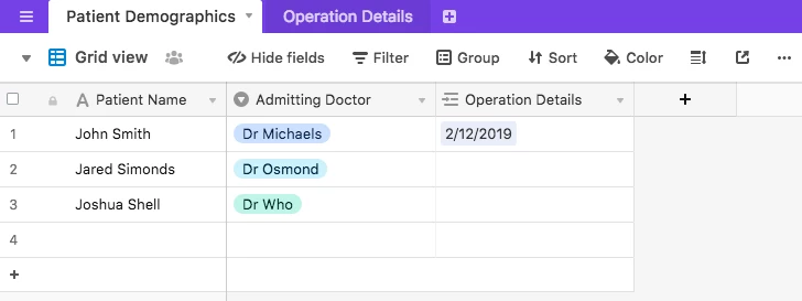

As far as I know, the closest you can get to this behavior is to use the Single Line Text field type, which allows for a default value to be set. Only a handful of field types have editable defaults.
However, I’m not sure that this matches what you want based on your original description. It sounds like you want the surgeon field on the Operation Details table to initially pull from the surgeon’s name on the Patient Demographics table, but still be editable if you want/need to change it. In other words, you want that field to initially be dynamic—driven by existing data elsewhere in your base—but also manually editable. Unfortunately Airtable fields don’t work this way. Their content is either dynamically-driven, or manually-entered. It can’t be both.
Yes, by using multiple doctor fields: one for the admitting doctor, the other for the operating doctor(s). For the admitting doctor, that could be a Lookup field pulling from the patient’s demographics record. For the operating doctor(s), this could be a Multiple Select field with the same choices that exist on the other table. Here’s that setup in a quick mockup I threw together. Is this what you want?
Thanks. Perfect advice.
Its a pity that it cannot be both as you have mentioned but your workaround makes sense.
