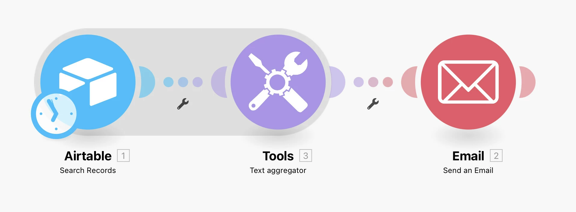

We are trying to automate email for master data with claim id with details from child database for same claim id - as detailed data resides in seperate child data base i am unable to create view , as claim id is dynamically getting changed for respective claim id in master table where trigger mail condition happens

Unfortunately, you can’t do what you want to do with Airtable’s native automation steps. Airtable’s native automations do not offer the ability to sort found records, and as you have discovered, if you try to specify a view, then you can’t specify a dynamic find.
You can achieve what you want to do by writing a JavaScript, or by using a low-code automation tool like Make.com.
Somebody else might chime in here to help you write a JavaScript for this.
Personally, I do not know JavaScript, so I always use Make.com for these types of automations.
Make allows you to find, sort, aggregate, and email records.
For example, below is an example screenshot of how easy this might be to setup in Make. This scenario searches & sorts records from Airtable, combines all of the results into one block of HTML text, and then emails the text. (Note that your scenario might be more complicated than this.)
