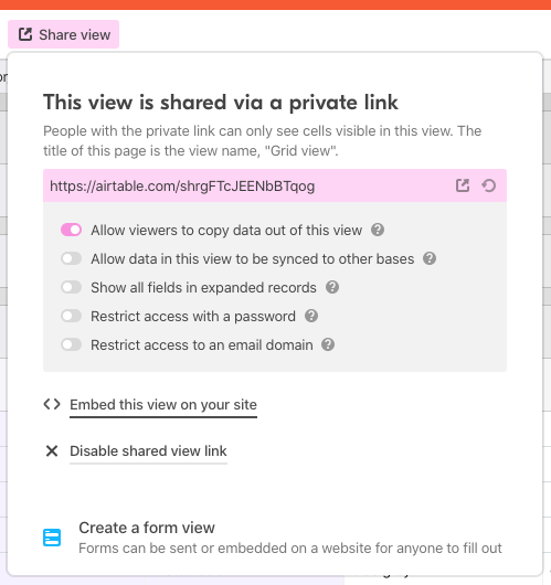

The embedded table can definitely have sort, filter, group, and search options. Just use the “Share” menu for your table/view and select the “Embed this …” option:

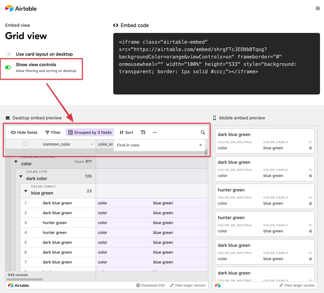

That will take you to an external webpage where they give you a preview of what it will look like for your users, in addition to the embed iframe code you need. You’ll see that you can choose to have the sort, filter, and group options hidden if you want – but by default, your users will be able to use all of those to view your books as they’d like:
