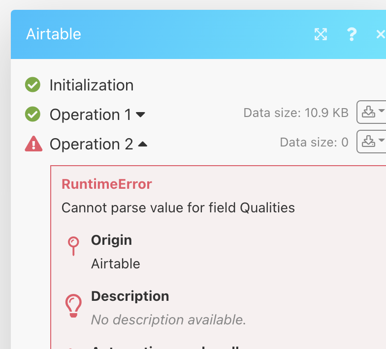

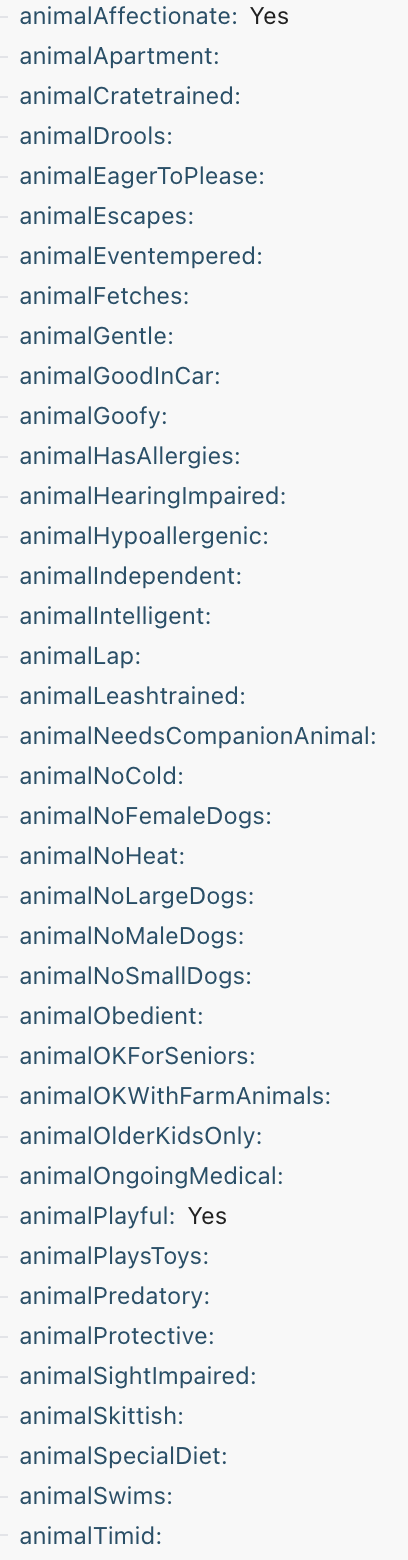

I’m trying to update a multiple select field based on info from an api. There’s 30 some values that will either be Yes or blank. If it’s yes, its works fine and puts the correct value, but gives an error if it tries to add nothing to the multi select field.

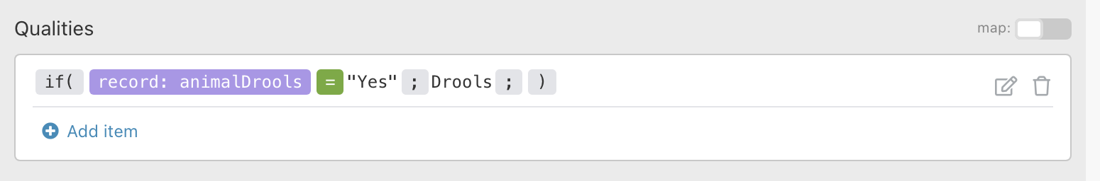

What I’ve tried so far:
{{if(206.record.animalDrools = “Yes”; “Drools”; )}}
{{if(206.record.animalDrools = “Yes”; “Drools”; null)}}
{{if(206.record.animalDrools = “Yes”; “Drools”; emptystring)}} * Doesn’t fail but doesnt leave it completely blank either
