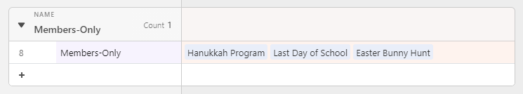

This certainly “works,” in the sense that I can input records and tag them with as many tags as I’d like. But when I go to output all the programs by tag/topic, the output is not at all useful:
Why isn’t this useful?
All programs with a given tag are listed on a single line and are not alphabetized or broken down separately. And the “count” at the top of each tag does not tell me how many programs are tagged with that tag.

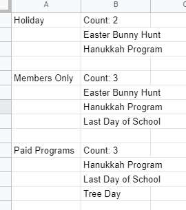

What I would LOVE is the ability to output something that looks a little like this…
Here is the same data (manually entered into Google Sheets!), only with each tag broken down, showing a count of how many programs there are for each tag. Also, the programs are listed alphabetically, which seems like a pretty basic requirement but somehow impossible (for me!) in Airtable.
Any way to accomplish something like the above using Airtable?

Airtable is great at collecting data, but when it comes to presenting that data in useful ways, its built-in views and features (grouping, filtering and sorting) don’t provide the type of control that most are looking for. To create meaningful output will require a bit more work.
Page Designer might be usable for some things, but it hasn’t been updated in quite a while, and is still quirky in many ways.
I’ll sometimes lean toward custom scripts, partly because I’m comfortable writing code to get the output that I want. That even goes into custom apps at times. I built a quick app a while back to show me data related to my planning system when another method kept failing.
There are also third-party tools that give you other ways of presenting Airtable’s data. I’m not very familiar with those (largely because of the costs involved)
I’m at a point now where I know what kind of output I can realistically expect from Airtable’s basic features, and what’s going to take more work. In your situation, I don’t see the output that you seek happening without either a custom script/app, or getting a third-party tool involved.
