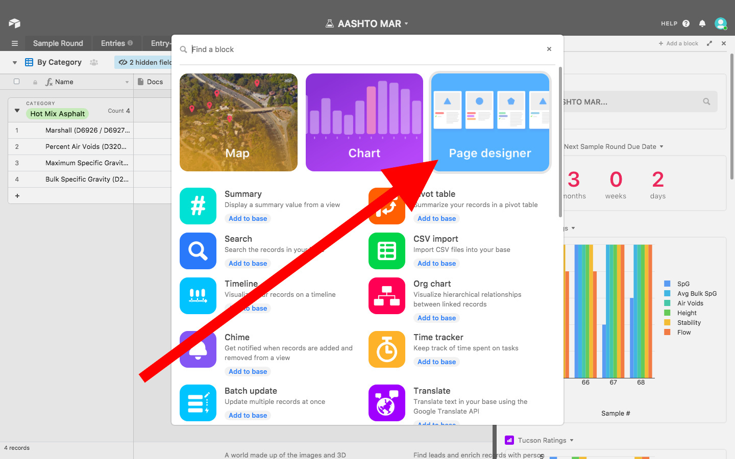

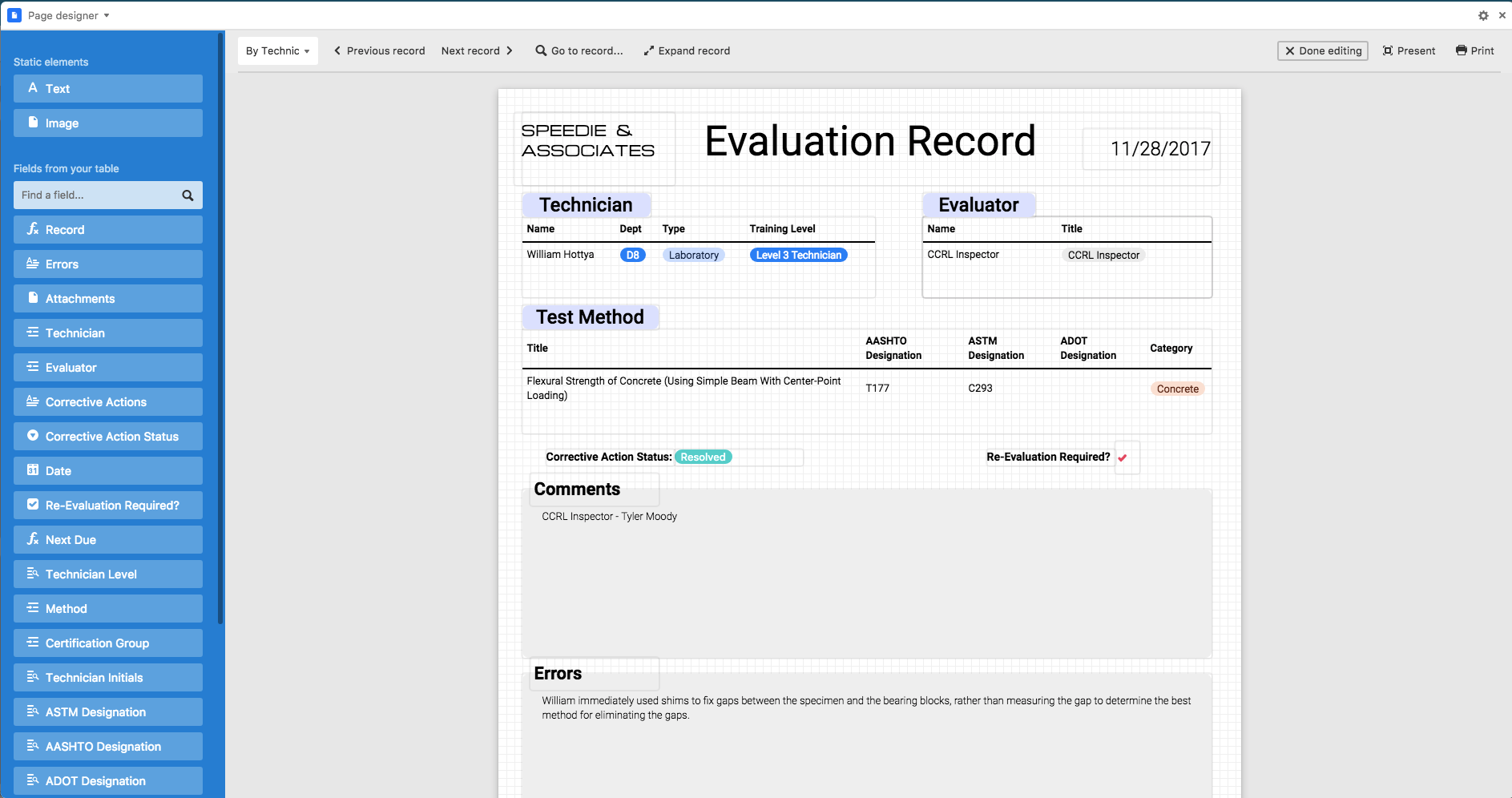

A second option is to use the “Pro” feature called Blocks - there is a “Page Designer” Block that allows you to design a layout using the fields of a table, on a page size of your choosing - it looks like this while designing, and has a drag-and-drop interface:

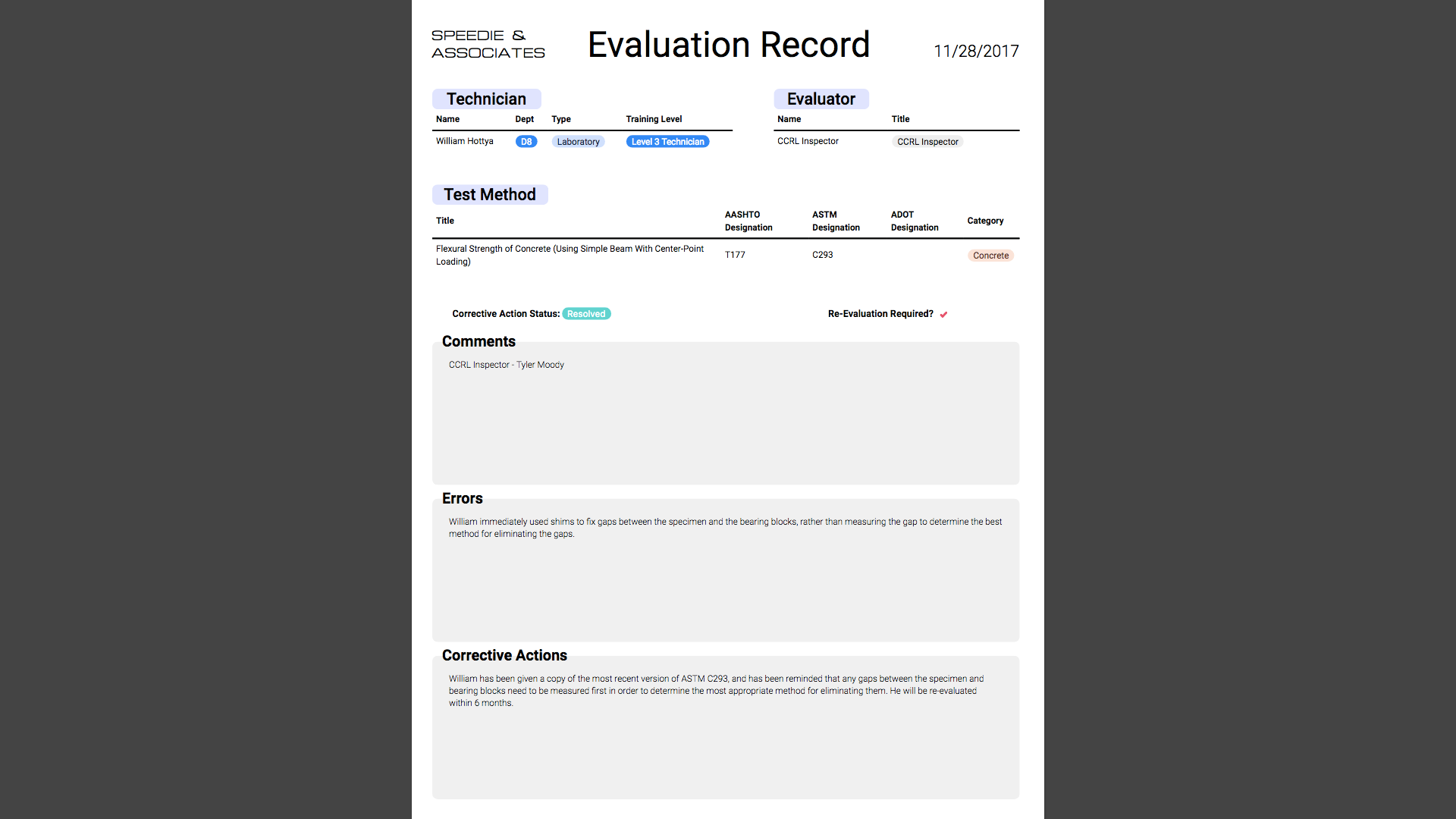

The resulting design will put each record into the same format, and the records can be searched or cycled through using the menu you see at the top there. You can then print, export as PDF, or present each record as a sort of slide (presentation mode):
My records do not include photos, but if you added an Attachment field that had a photo in it to a design, it would pull the photo into the page, so you could design a layout with the photo and any information in fields you would want to add.

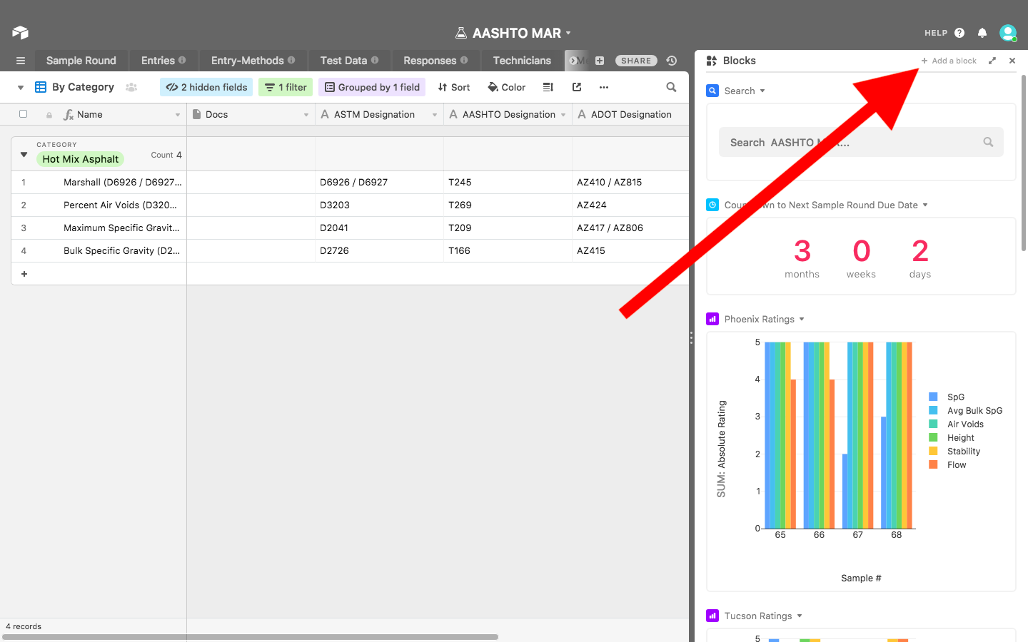

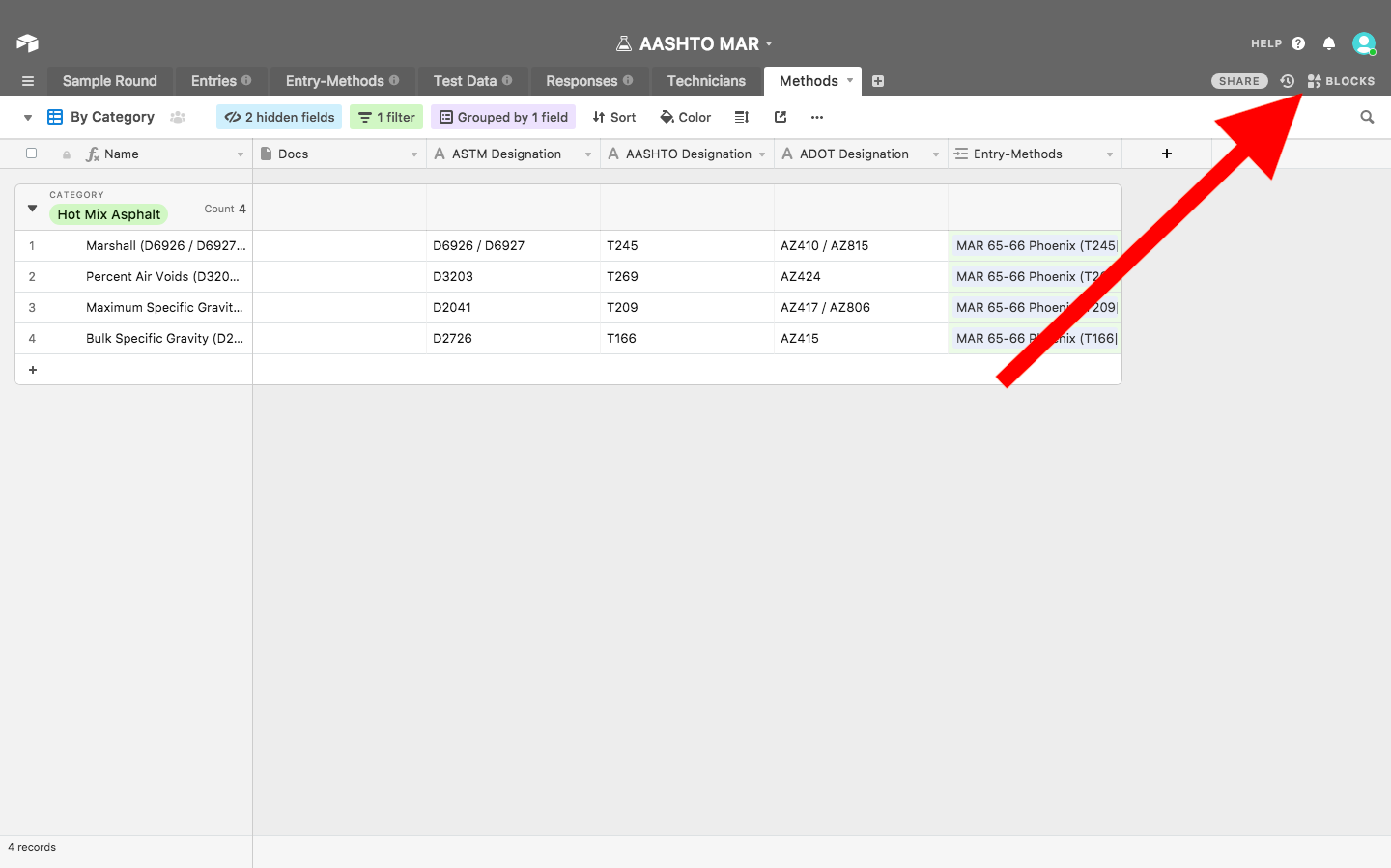

You have to have a “Pro” subscription on your workspace. If you do, you can access the blocks with the button of the same name in the top right corner:

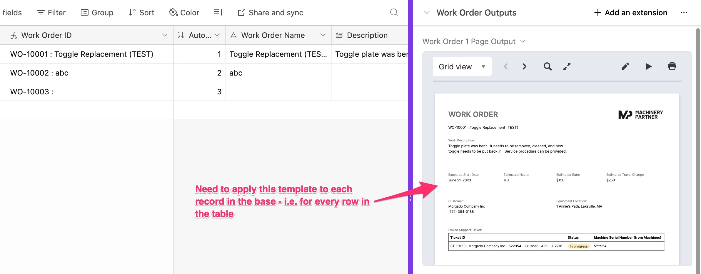

Great post, Jeremy.  Do you know how to have the Page Designer template cycle through and apply to each record in a table?  The use case is that I created a table for "Work Orders" and I want to produce a 1 page output for each service technician.  I created a template but now want to apply it to each record in the table.  I do not see a way to create this output using the page designer for each record.
