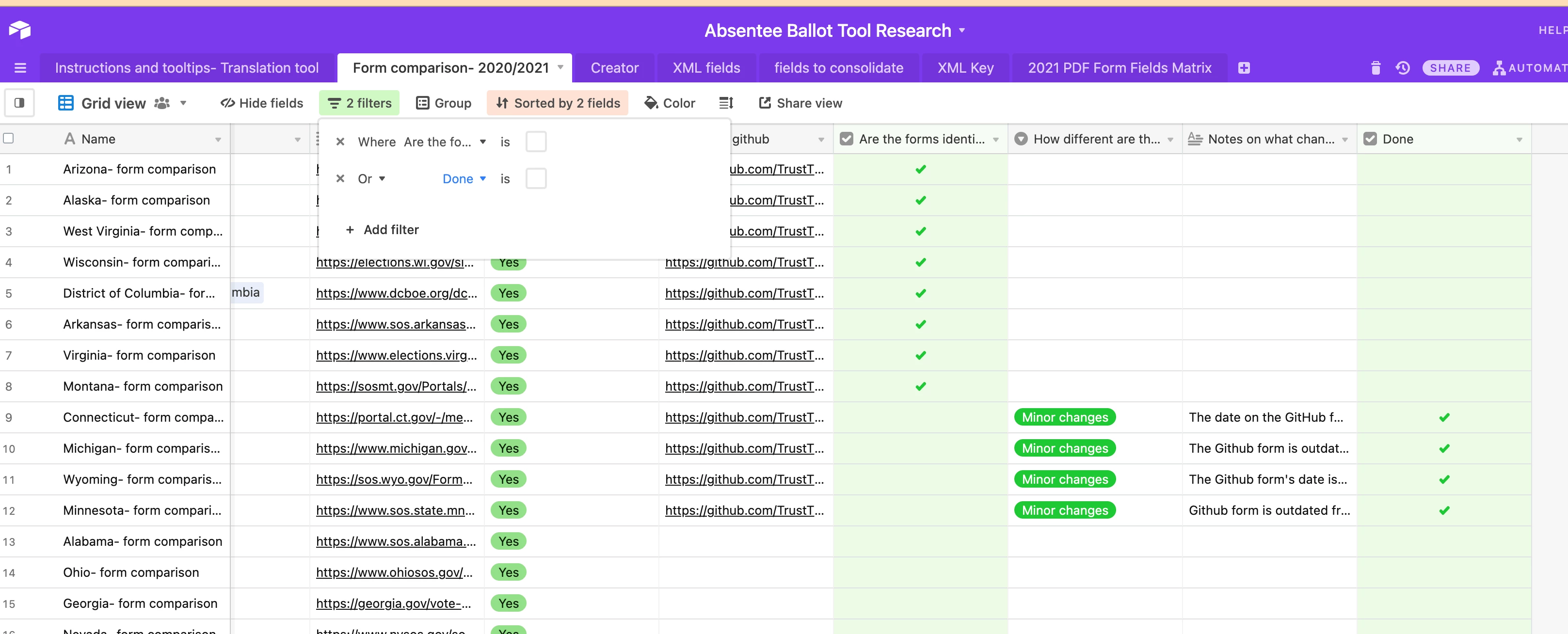

I’m trying to set up two views with opposite information. In one view, I only want the records that are not done, or are not identical to show, so I want two things filtered out:
“Done” is unchecked OR
“Are the forms identical” is unchecked.

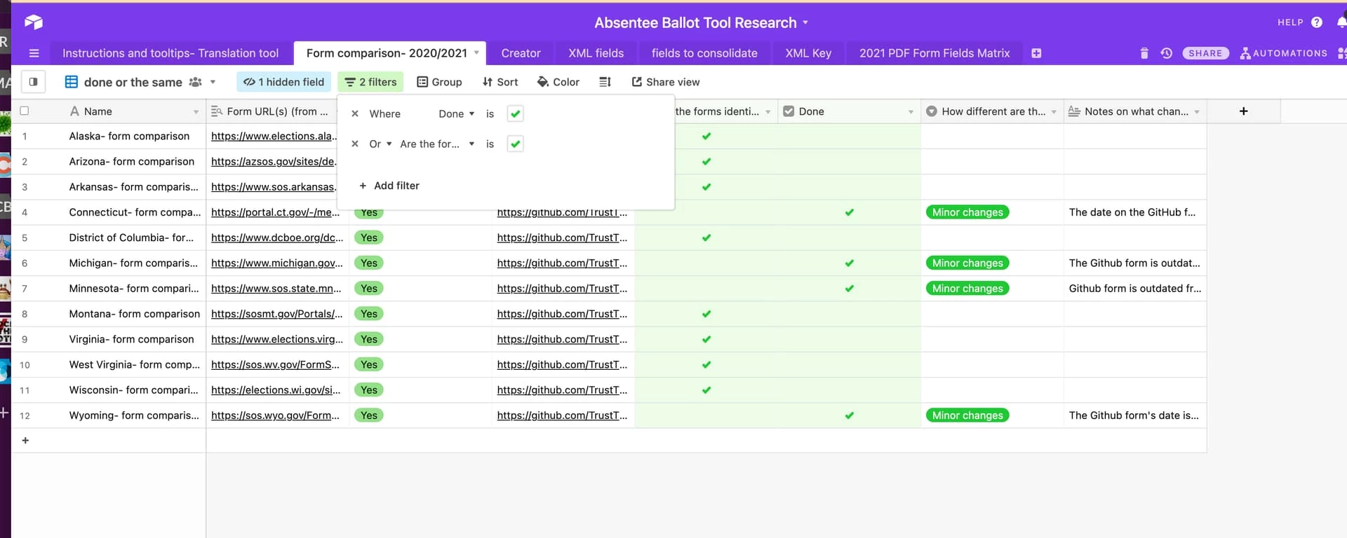

On the other view, I want the reverse- records that are done or are identical, so I have the filters as:
“Done” is checked OR
“Are the forms identical” is checked.
However, the first view is only working if I select AND instead of or, even though I am not looking for records with both of these conditions, rather, either of these conditions. What am I missing here?
Screenshots:
The view showing the records I want to filter out, and the filters I think should do it, having no effect.

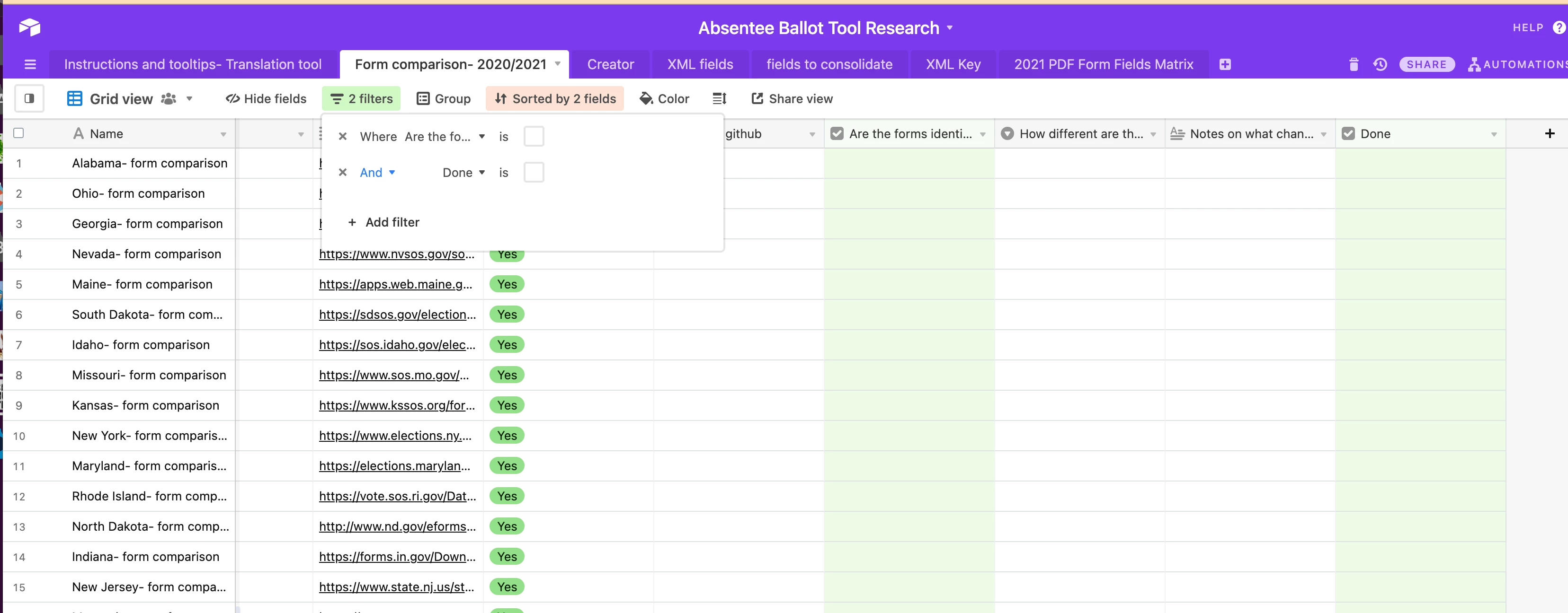

Same view with the records filtered out, with AND instead of OR.
The other view, with the reverse records- using OR.

I think this is the problem. You’re not thinking correctly about the filter system. You’re not filtering records out with the conditions that you set. You’re filtering out any record that does not match those conditions. In other words, the filter determines which records are kept, not removed.
In your first screenshot, you’re using OR between the conditions, which means that a record will be kept if at least one condition is met. All of those visible records match at least one condition: they either are not done OR they’re not identical. If a record is identical but not checked as done, it still matches the not-done condition, so it’s left in. If a record is done but not identical, it still matches the not-identical condition, so it’s also left in.

I think you’re not describing the logic correctly. Let me go back to your original post for a moment.
If it works with AND, then AND is how it should be. I’m not sure why you feel it should be OR, because the output that you get in that second screenshot—the one that you say is working, where neither checkbox is checked in any record—matches the logic when using AND.
The OR option means that only one condition must be met in order for the record to be kept in the view. If the other condition is not met, it doesn’t matter. At least one condition passes, so the record is kept. Going back to how that first screenshot looks, each record successfully matches one of the two conditions. One checkbox is unchecked in each case. It doesn’t matter that the other checkbox is checked.
