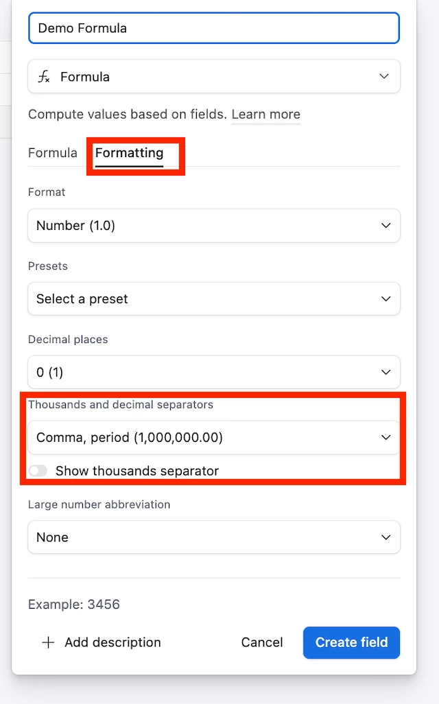

Just in case anyone is still getting here via search results all these years later, the answer I found was here: https://support.airtable.com/v1/docs/common-formula-errors-and-how-to-fix-them
In short, click on Edit Field, then above the formula box there there is a tab for Formatting. You can solve basic number formatting that like the 100000 > 100,000 that way. Hope this helps!
For further reference to ​@Rachel_Stephens’s point:
