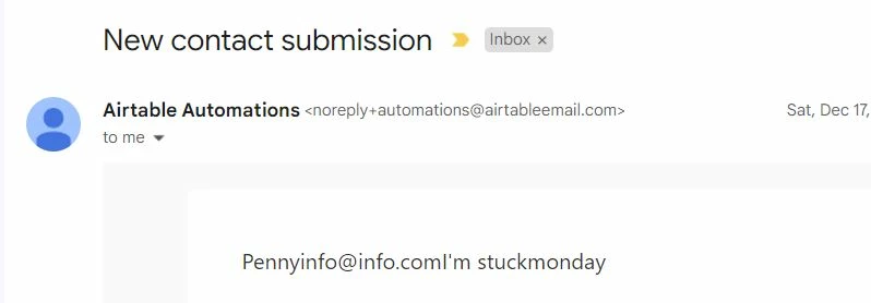

Hello there!  New to AirTable.  On a small website  I have a small Contact Form that is populating data into my table inside of AirTable.  It's all working just fine in a local site (not live yet, but it works)  I only have a few fields, which are getting returned to am email notification automation, but the fields are all showing up in the email notification all squished together and look like this:    Pennyinfo@info.comI'm stuckmonday
My fields are:  Name, Email, Message, and BestDay   So, you can see that the info IS getting to me which is great but how can I get the fields to at least show on a different line in the email I receive?  It's too hard for me to read ;-)!
I understand how to use markdown for the rest of the body of the email, but not understanding how to format the actual 'data' that is coming in to me via a contact form on my site after it lands in AirTable??   I tried putting the fields inside of curly braces but that did not work either...

  • BUT haha here's the issue:  data inside the notification is all squished together on one line not separated nicely like your's above.  Mine looks like this:  Pennyinfo@info.comI'm stuckmonday  | where as the fields in the table are:  name, email, short message, bestday

Have you tried to add <br> <br> after each field?
like:  Name   <br> <br>  email

haha it's almost comical, well no I'm still doing something wrong: you can still see the data above all squished together; followed by normal html...
Screenshot:   https://prnt.sc/_YxwVmKPFNxv

You have to add them as you did before, clicking on +
one field, after <br> and after click again on + and select the other field etc

It seems that you just Type the column name.

Ongosh LOL that worked!!  Thank you!!  Wonder if the instructions for that could be updates slightly; I never would have been able to figure that out without this thread!  (that's why the Community is so great tho ❤ )
Thank you so much!  I will mark as solved!
