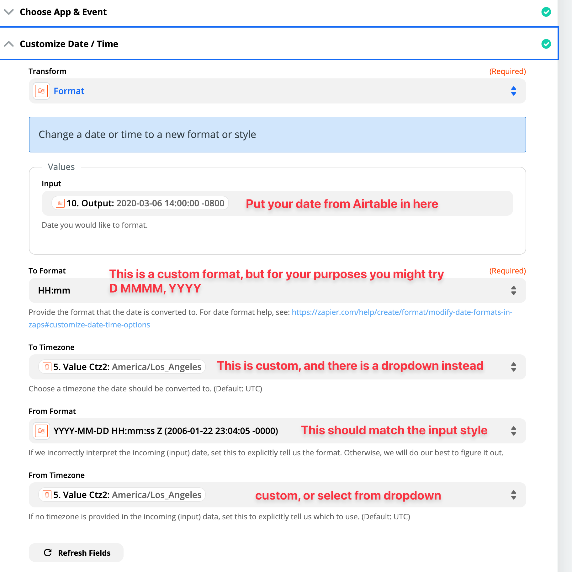

Formatter by Zapier gives you the option to formulate date/time so you can reformulate your date from Airtable: I’ve pulled this from one of mine, but it should give you an idea
I knew someone probably had experience with dates in Zapier, but I’m puzzled by this screen. If Zapier allows you to transform the date to a specific timezone, what happens when an invite is then mailed to someone in a different timezone than selected in the configuration?
