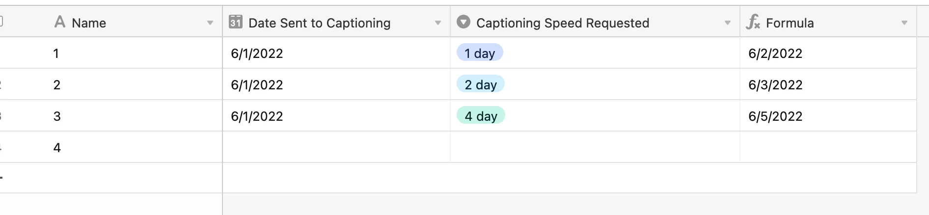

JonathanBowen
Hi @Dan_Pinsky - yes, I think oyu can simplify this, removing the BLANK():
IF({Date Sent to Captioning},
  SWITCH(
    {Captioning Speed Requested},
    '1 day', DATEADD({Date Sent to Captioning}, 1, 'days'),
    '2 day', DATEADD({Date Sent to Captioning}, 2, 'days'),
    '4 day', DATEADD({Date Sent to Captioning}, 4, 'days')

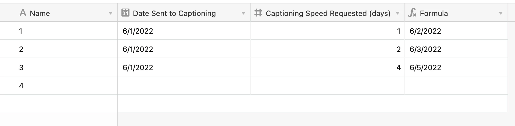

You could also consider making the “Speed Requested” field a number:
which simplifies the formula some more:
  DATEADD({Date Sent to Captioning}, {Captioning Speed Requested (days)}, 'days')

Or leave it a single select and use VALUE()
  DATEADD(
    VALUE({Captioning Speed Requested (days)}),
    'days'
