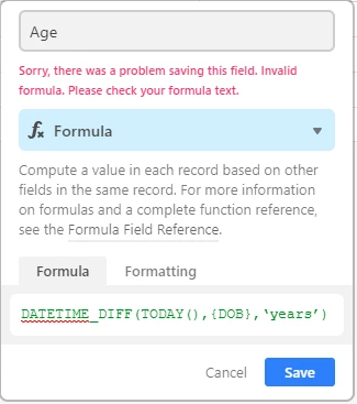

My field is named DOB but I get this error message.

@Terri_Bose, the problem is with your quotation marks. If you notice, the quotation marks you have around the word years are slanted - these are a special type of unicode character called “smart quotes”, and they are not compatible with Airtable’s formula editor.
Copy and paste this version into your formula editor:
DATETIME_DIFF(TODAY(), {DOB}, 'years')
The quotation marks there are straight up and down, called “dumb quotes”. It’s a finicky thing, but Airtable’s formula editor only accepts dumb quotes. When you copy text for a formula from the forums here, if that text is not inside a code block (as mine is above), then you will likely end up copying “smart quotes” out of it. You just have to be careful and keep an eye on those when you are pasting it into Airtable’s formula editor.
