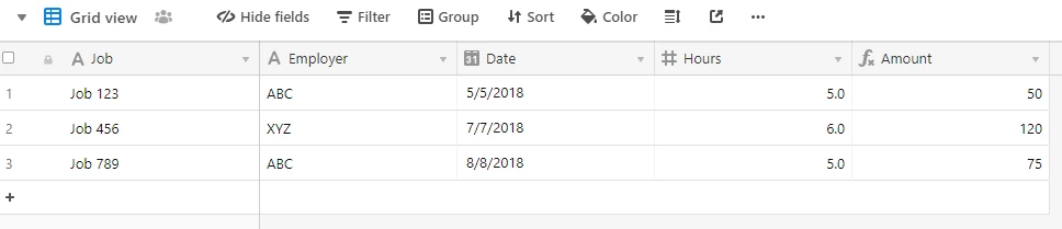

Hi Taylor,
You’re looking for nested if statements. In this mockup, I have hard set the rate for company ABC to be 10 before 7/1, 15 after 7/1… and all other employers at 20. Obviously will need to modify to fit your needs, but hope this helps get you started.
IF(Employer="ABC",IF(IS_BEFORE({Date},"7/1/2018"),Hours*10,Hours*15),Hours*20)
