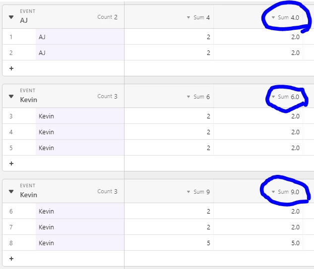

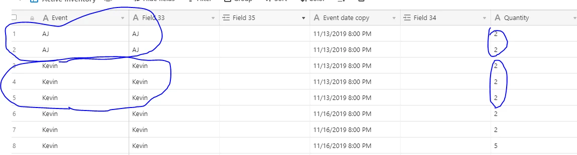

I wanted to use a formula to combine these unique QTY’s across the rows. Could i use one formula that would be able to combine all these rows into a singular QTY for their unique groups? For example Kevin has two unique dates one with a combined QTY of 6 and the other with 9, whereas AJ has a unique QTY of 4.

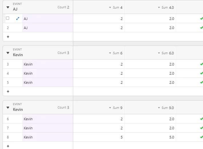

I’d suggest you try using the “Group” feature at the top to see if that will suit your needs. In your “Events” table, Group it first by “Person”, then by “Date”.
You’ll end up with sections that have summary bars on them. You’ll have a top-level section for “AJ”, and a summary bar that shows AJ’s total Quantity for all dates. But then inside the AJ section, you have sub-sections, one for each “Date” (which presumably represents an event). Each “Date” section will also have its own summary bar, showing AJ’s total Quantity for just that Date.

Thanks for the reply, unfortunately i do have this view but due to constant movement around this table i need these QTY’s inputted into a different table, so I can run different formulas off them with a different set of views and purposes. I’m trying to figure a way around inputting this unique data manually into the separate table by making it automatic if I have linked records, a list table, etc

All I really need is the circled number in this pic inputted automatically into its designated row on the next table.
