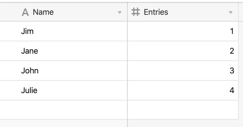

Hi @Steve_Long - don’t think you can do this with a formula, but you can do it with the scripting block. My method is to create an array which has the names represented as many times as each person has made entries to the draw. So if my table looks something like this:
then I end up with an array of names like this:
["Jim", "Jane", "Jane", "John", "John", "John", "Julie", "Julie", "Julie", "Julie"]

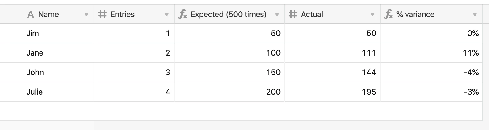

To test it out I ran a modified version of the script which looped through the process 500 times and saved the winner each time to another table. The results were:
Based on this, if I ran it for 1000 iterations or 5000 iterations, we should get closer and closer to the expected results.
