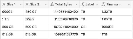

Here’s my test table:
Notice the last two records. Many assume that the different levels of size are simple multiples of 1000, so 500GB doubled must be 1TB. However, they’re actually multiples of 1024. That takes me back to the first record, which is based on your original comment, and which shows that the true sum of 900GB and 450GB is 1.32TB, not 1.35TB. Gotta love computer math! :slightly_smiling_face:
