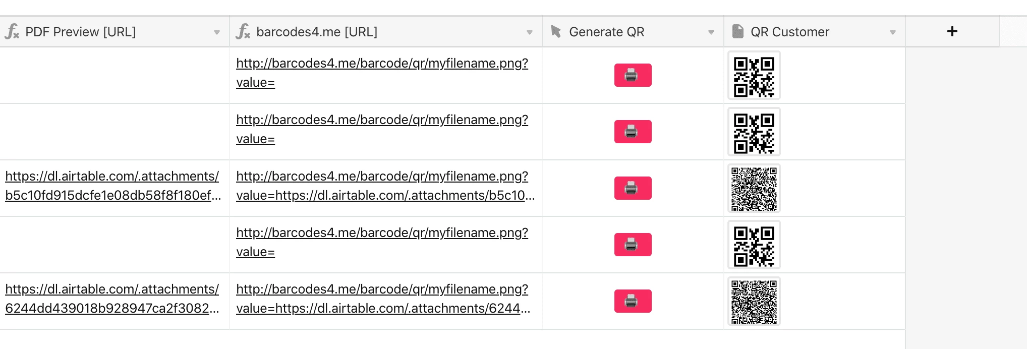

I’m using a script that generates a QR code as an attachment.
Here’s the structure.
The script that I use (shared by someone here) will:
1. Generate QR codes for the record as an attachment.
2. If this record already has an attachment, skip it.

How to modify the script so it would only generate the QR for a specific record and not all?
I get a hint in AT but entirely sure how to do it.
Record from button field was not used
This script did not use the record from the button field. To use a record from a button field, call input.recordAsync in your script.

Bill_French
  • Oct 21, 2020 12:26 PM UTC
The most efficient end elegant way to encourage script to apply logic conditionally is to read the data from a view, not a table. If the view includes only the records you need to process, you needn’t write any logic testing for this condition. The code is simpler, the processing is faster (because you’re only reading the records that matter), and the system is more agile (i.e., filters can change on a dime; code not so much).
