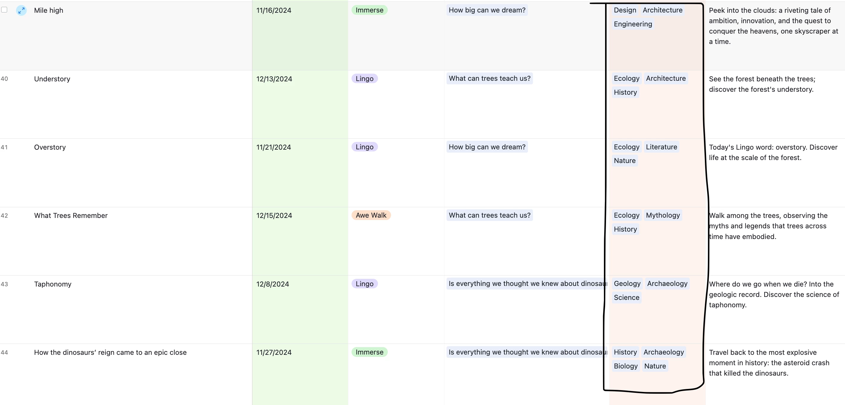

Hi all--
Thanks in advance for your thoughts. I have a items shown in the attached that are different content that have different topics associated with them (you can see the column of topics). I'd like to get a view in Airtable where I see all of these segment names associated with the individual topics in lists in 1 view.  The way I've thought about doing it is to try grouping them, but when I group them, they sort with the 4 topics together, not as individual topic lists. Grateful for any advice on how to do this!
Ron_Daniel
  • Nov 11, 2024 8:38 PM UTC
It looks like the topics are being pulled from a linked table. I believe you'd want to create the view you're looking for in that table - since each topic would have one record, with a field showing what content pieces have been tagged with that topic. This will work even if the content piece has been tagged with multiple topics, since the content piece would show up as a listing in each topic.
