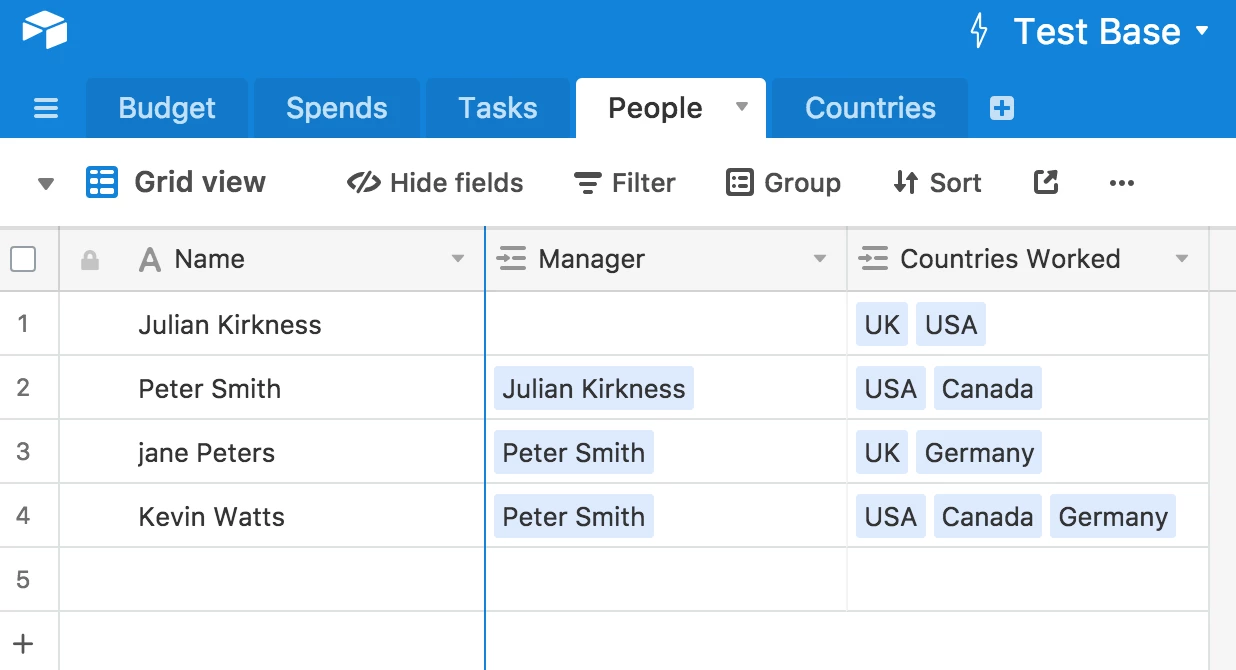

Hi Stephen

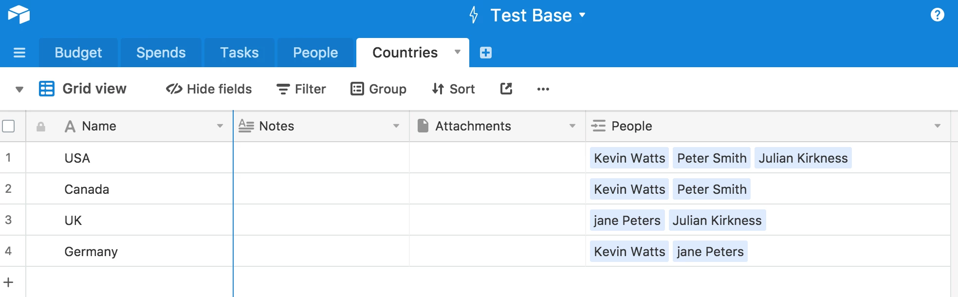

I think the best way to do this would be with a Linked table of countries you would see the countries a person works in against their record and a list of people working in a country in the country record:
You would be able to enter the information in either the Countries or People table in this example.
