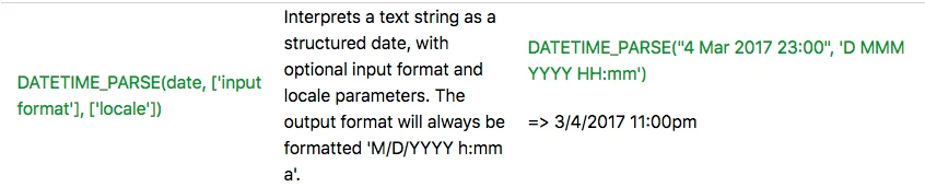

AFAIK, is it possible to use also logical operators to compare dates. Anyway, the key is how to enter a date string that is valid.
According this post, the format depeds on the browser locale/language. The best way is to use DATETIME_PARSE so you tell Airtable which format is the date written.
