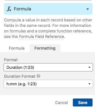

Check the Formatting tab on the field settings:
Also, you can use simply IF(Today,ET).
@Elias_Gomez_Sainz OMG #lol I can’t believe I tried for an hour with this DATETIME_FORMAT command #facepalm - Sometimes solutions are so easy. Thanks for pointing me to the formatting tab :winking_face: Problem solved!
